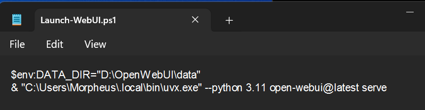

New to this LLM stuff as well... got baited in from the Gemma4 talk... (hopefully this isn't hijacking.. but could be useful for someone that is as new as I was.. I know this is most likely elementary for some of [H])
I'm on a Windows workstation; home rig with a 9070 XT. My main use case would be my own PowerShell collaboration partner to assist me with scripting, etc.. as my main job is a Windows system engineer...
So far I've downloaded/installed Ollama, Python (along with uvx) installed Open WebUI (this binds to localhost:8080)
I then launch Open WebUi in an isolated environment (whenever I want to utilize the LLM's via the web ui)

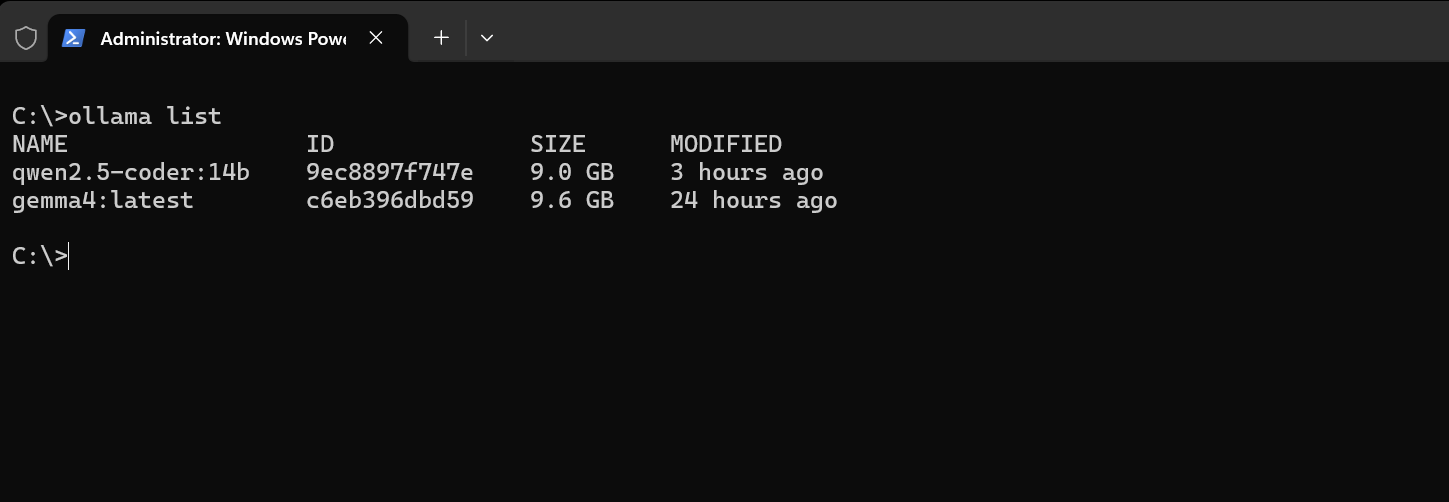

Then my AI virgin self learned to pull down the LLM's I need to run the following, which I have so far pulled down:
ollama run gemma4:latest ( this pulls down the E4B size I believe )
ollama run qwen2.5-coder:14b
And .. away we go...

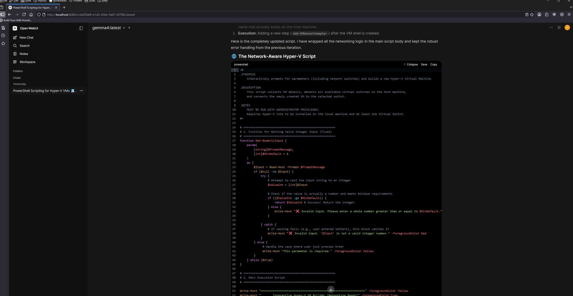

This looks nearly exactly like what I'm looking for except not powershell.
Also, as OP said, it's not hijacking because this is literally what I was asking about on the other thread.
