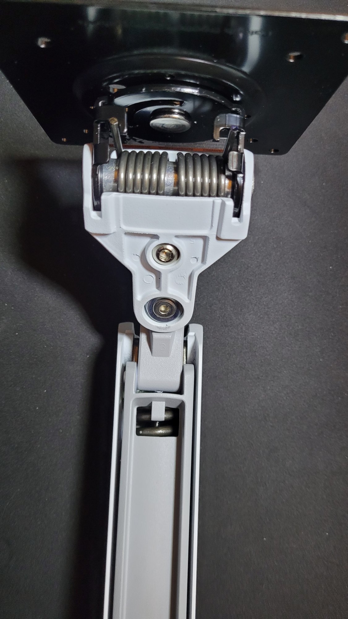

All the cheap ones sag.
If not today...
So i suggest investing in an ergotron arm.
LX is the light series
HX the heavy duty one
Even the light variant looks great:
The small hex in the middle is where you tighten that axis
ps there usually is a second hand market for these if you want to hunt one down for cheap
And don´t always believe the "max inch" statement on the first page.
That has more to do with artificial marketing segmentation.
Use the ergotron monitor search function which will give you a green light for even bigger ones.
Since it´s german i´ve already picked the desk clamp and all "moveability" options for you (they don´t do pivot):
