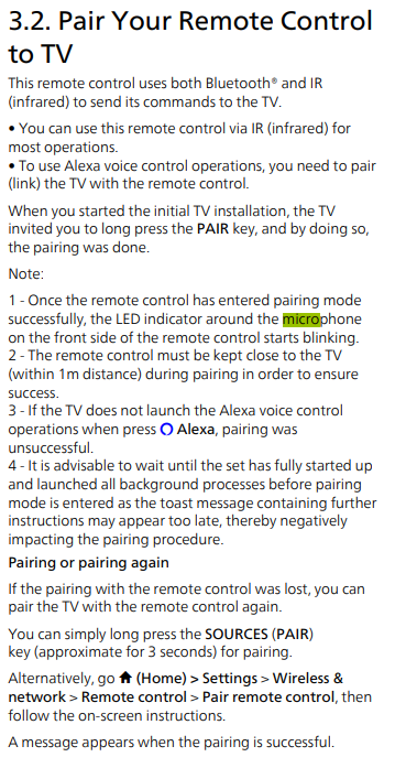

We did a firmware update and i looked under sound, and there was nothing with microphone.
did you rtfm and pair the remote?
We did pair the remote pressing that blue circle icon on the top but i dident notice any leds blinking on the mic. I will try and pair it again when my mother gets home.
But i tryed to look under sound settings and there was no options for the mic. Is that normal ?
no idea
Strange now it suddenly dosent work...it just worked and now it dosent.
Pressing that blue icon dosent do anything now....
There was no options to re-pair the remote and the pair botton dident respond or do anything.
So i tryed to pull the power cable out of the power outlet and install it again. This worked.
So it seems to work now.
