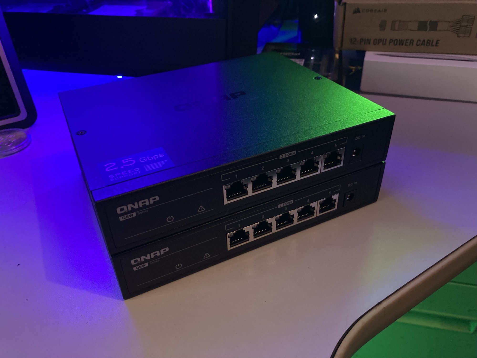

I bought a pair of these QNAP 2.5GbE switches, one upstairs hooked to the router and the other downstairs in the garage.
2 of my machines have onboard 2.5 and I bought a $25 2.5 nic for my Plex Server. I also bought a 2.5GbE USB-C adapter for use on devices that don't have onboard 2.5.
