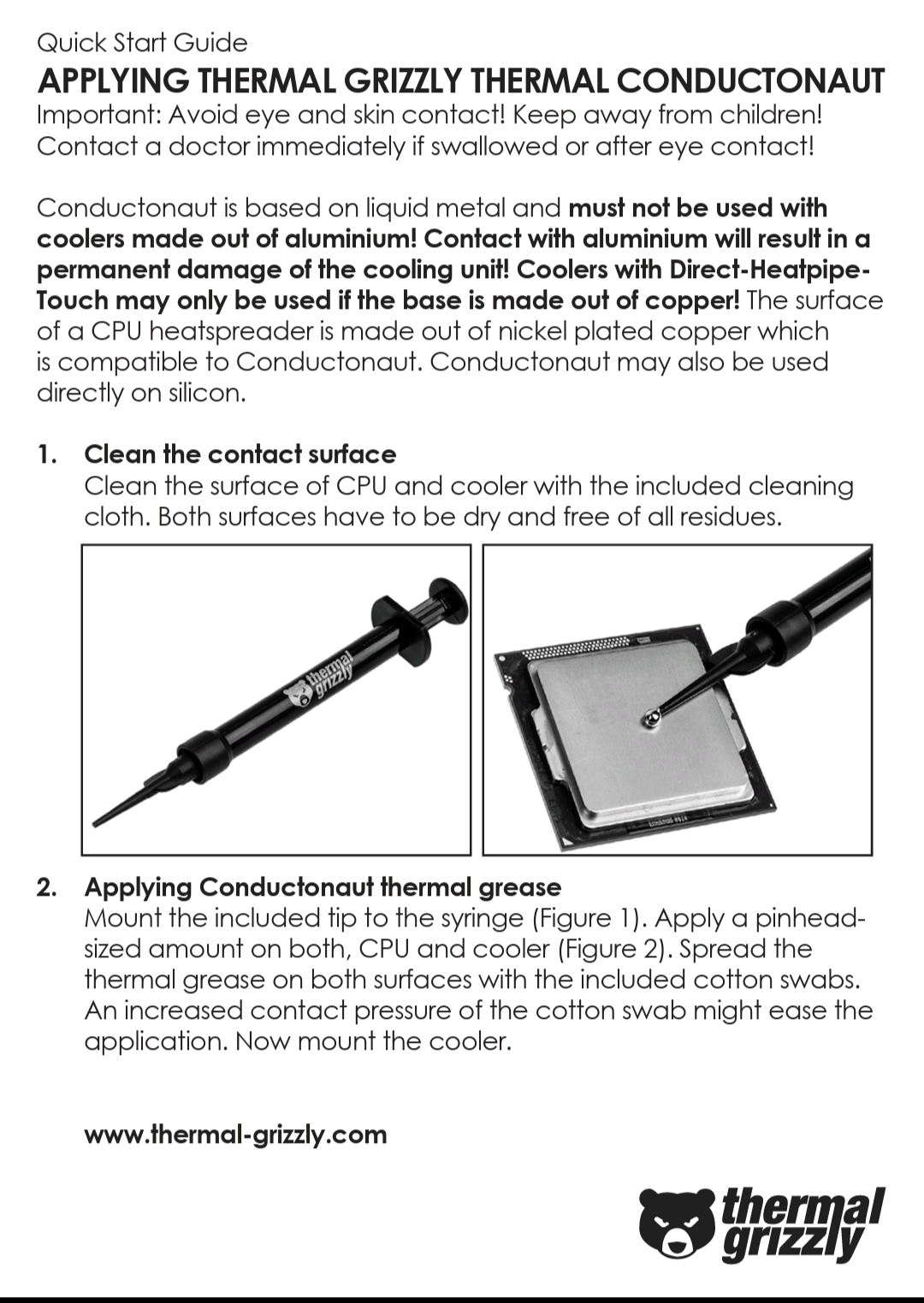

Never put gallium (main ingredient with liquid metal TiM) with nickel aluminum. Keep it on copper.
Never put gallium (main ingredient with liquid metal TiM) with nickel. Keep it on copper.
So I should have lapped everything first....
Problem is, thermal Grizzly says that it is fine to use with nickel.
And with copper, it forms an alloy with it / soaks into it.
Sorry, I meant aluminum. With nickel, it creates that staining, but doesn't affect thermals.
Oh yeah it does effect thermals with nickel. Maybe not short term, but after a while it gets really horrid.

I'm surprised Thermal Grizzly haven’t been hit with a massive class action yet. Doing their bit to send good kit to landfill before its time.
Nobody is forced to use it, it does transfer heat extremely well, and they do warn about damage (although not sure about this specific type of damage).
End of the day, it's extreme cooling for extreme applications, where damage to the hardware is not only possible but likely. If you aren't pushing your hardware that hard and you don't want to risk it...don't use it.

Yeah, I learned my lesson. I hadn't seen any warning about it messing up nickel and was kind of surprised when it did.
