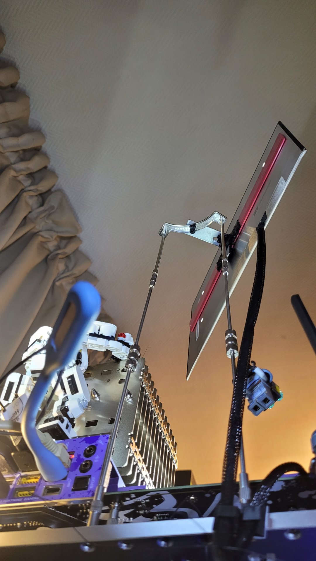

Next motherboard you buy keep an eye out for an "eDP" video-connector.
Those are made for internal video and power transport.
I use one on my bench with an asrock side panel 13.3 kit. Nothing special

I'm not even familiar with this connector at all, sounds like it would be perfect for what I'm looking to do, I will look into that as well, thank you.
It can also be connected via usb 2.0?
Nifty!
... so it can be install it on .. basically any internal usb connector.
