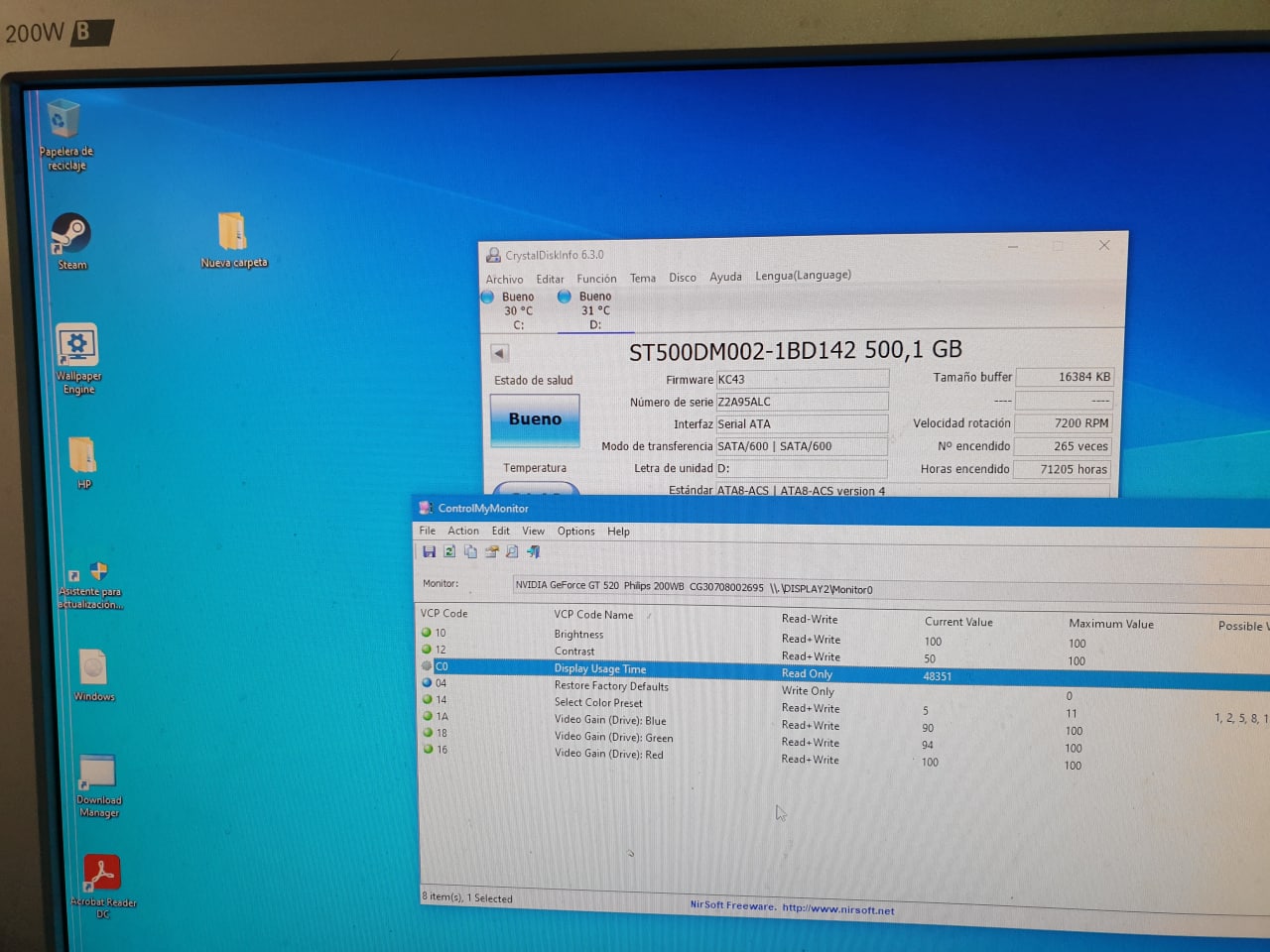

I have a Philips 200WB monitor that shows 54,000 hours of use, it already looks a bit yellowish, but it still has a good brightness. Of course, the screen has a red vertical line, but it does not affect its operation.
The only thing I had to do was change the capacitors.
Here is an old screenshot.
In the photo you can see 2 red vertical lines, but from one day to the next they disappeared and only one line remained hahaha.
Last Sunday he decided not to turn it on anymore, and it turned out that 2 Nichicon capacitors couldn't take it anymore, the poor guys, almost 60,000h worked next to a mosfet at high temperatures, and on top of that, put in a cabinet working over 36 degrees of ambient.
I swapped them out, and it's back to life, and will continue to run until I finish my CCFL tube lifespan experiment.
