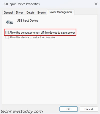

in device manager, set the hub it is on to never power down and turn off selective suspend.
in power settings set "turn off hdd after" to never
try that
via technewstoday,
