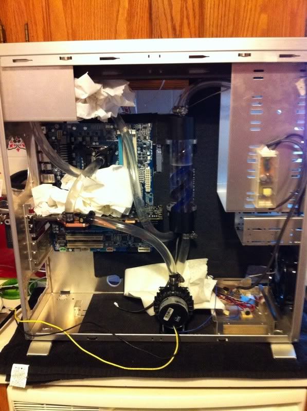

Another update! Got mostly everything mounted and the tubing run.
Does anyone have any suggestions for covering my cuts to the brace near the top? Its just covered with white electrical tape right now lol.
id change that loop to cpu then video card...gpu is easy to cool ...
find rubber oval gromlets..if you cant putty would work... not great looking tho
also make sure you have that inlet right on the cpu.. i cant see it well in the picture looks backwards..usually the left side is inlet
auto stores have black trim for door edges to protect the paint that you could use, or you could get black rubber vacuum hose from auto store and cut a slit in it and push it around oval.
If flow rate coming out of your pump is not an issue, then the order (CPU then GPU or vice versa) does not really matter. However, the reservoir should immediately feed into the pump. I have tried different iterations of order and at best, there is a 1C difference. What I have noticed is that having multiple serial radiators did helped some (2-3C without fans or 4-5C with fans) as long as your pump can handle the flow restrictions.
The CPU inlet is right, I double and triple checked, its just that the block is rotated to allow an easier bend from the GPU to the CPU.
I'm liking the black vacuum hose idea, or maybe somethings like the plastic tubing for cables.

Alright guys, I am now leak testing!
Man I should have gotten a flow meter, its really hard to tell that the liquid is actually moving, but I can hear the pump humming away so its got to be pumping right? Lol.
Also, all of these little tiny bubbles attached to the tubing and the res will eventually work themselves out right?
yep, those tiny bubbles will eventually disappear. You can see any movement on the surface of the water in the res? That's how I can tell mine is moving.

tip the case back and forth , give it a shake to loosen the bubbles... they will all clear out in time... after a few hours open the top screw to the res let some air out...i would have put a flow meter...just to make sure the fluid is moving...
