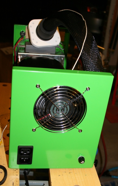

Some of you might remember my vapo-li line of product which puts single stage in lian-li v2000 :)
I've decided take a stab at different segment of market of people who might not be interested in V2000 case or already have good case and don't want the extra cost associated with V2000 case.
First of it's kind for customer build... with optional color...
This is as barebone model as it gets with no controller no temp read out, just 1 k-type probe attached so customer with good thermometer can read temperature of evaporator.
Casing is made out of heavy duty 16 gauge steel to handle any potential shipping damage without hitch than powder coated. Typical color supplied is glossy black.. yes I have one bencher SS made in this case with black :p)

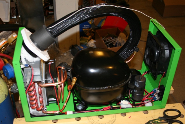

NF9FX is what I am using unless otherwise requested (I am playing with NF11FX in one... sounds as loud as vapo LS on that one). About 10c better than stock Vapo LS on NF9FX under heavy load, about 13-15c better than stock vapo LS on NF11FX so far... :)

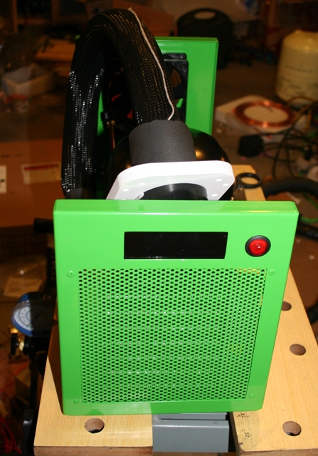

The black one. This one... is bit different :)
NF11FX :) Bit more powerful, bit louder (vapochill like), bit more power consuming...

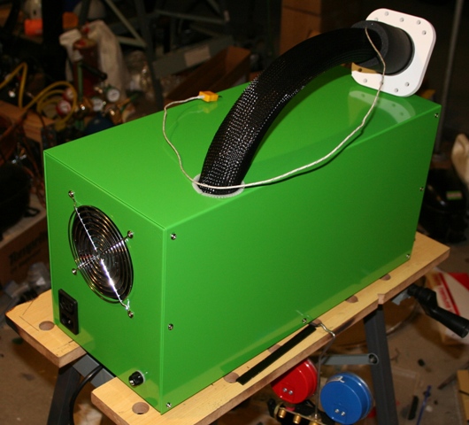

Also, it has braided suction line... and....
LOOONG suction line. OPB asked for it so he gets it. Flex part of suction is about 6ft... looong...
As I said... black powder coating is my staple stock one. I like it :)

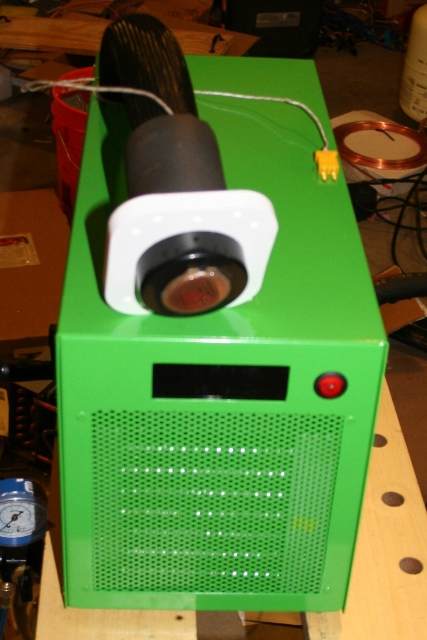

The wires extending are #1. Zalman Fan mate controller to speed control fans.
#2. K-type probe... I think it was about 8ft-9ft long since suction was so long :)

Very Cool...like a black Anaconda crawlin' out of the case. :^)
OPB must be goin' across the room, with that six footer.
