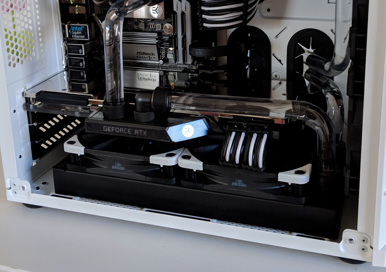

1080ti was starting to show artifacts so ... I put this lego set together this evening.
Gawd this is an expensive card plus waterblock plus 2 year warranty at Microcenter. She better fucking deliver the goods.

Dang! It looks great! I am jealous! Are you happy with your investment so far?
Its an expense haha. Totally not an investment.
I am actually happy with it. Surprisingly runs cool. I was playing Metro Exodus with full RTX stuff on @ 3440x1440 at 100fps gsync and card was running between 40 and 51c. Really good block this time around from EK.
In many of the titles I play the 2080ti feels no more faster than the 1080ti but I notice the min fps in some really heavy scenes is higher by quite a bit.
My cabling was rough in the picture from me pulling on it and moving it etc... to hook up the card etc... I will redo the cable management later.

Watercooling a GPU takes some technical skill. You have to remove the fan shroud, install thermal pads, remove thermal interface material from the GPU chip itself, prep surface, apply much better compound like Thermal Grizzly, apply the block and proper pressure and backplate thermal pads for the backplate.
But thats the easy part. You still the complexity of a non-leaking main loop, a pump, a cpu block (if you want) a radiator, fittings, hard or soft line.
Not too bad, expensive to get into but the equipment can be transferred to several generations of upgrades and new systems. So its really a first time investment into the main core watercooling equipment.
