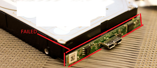

Well, that would tell me if it works or not, but I assume there is a USB controller and if the controller is toast I guess I cannot get another one?

yeah, probably not an identical replacement (unless you get lucky and find a parted-out enclosure/PCB on Ebay) but if the disk itself is ok you could always get a comparable 3rd-party enclosure for ~25$ and put it in there.
HDD never showed up under BIOS. I took apart the HDD casing and I can confirm that the controller failed. Connected it via an enclosure with a power brick and plugged into a computer via USB and I can see/access the contents of the HDD. So when I buy a new enclosure for this 2.5" drive, do I get one with or without a power brick?
