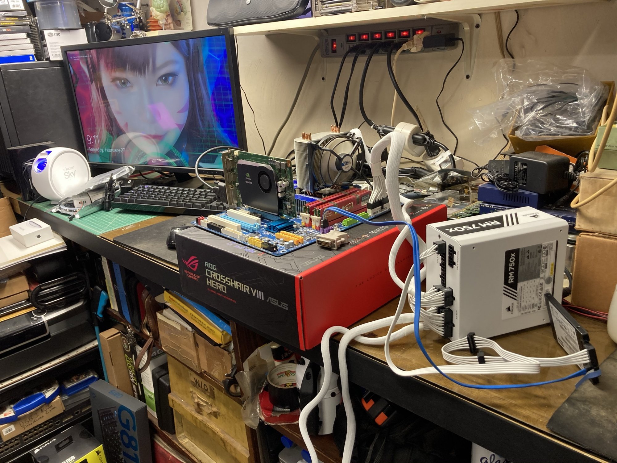

take it out of the case and make sure everything looks clean and dust free and hook it up on your desk.

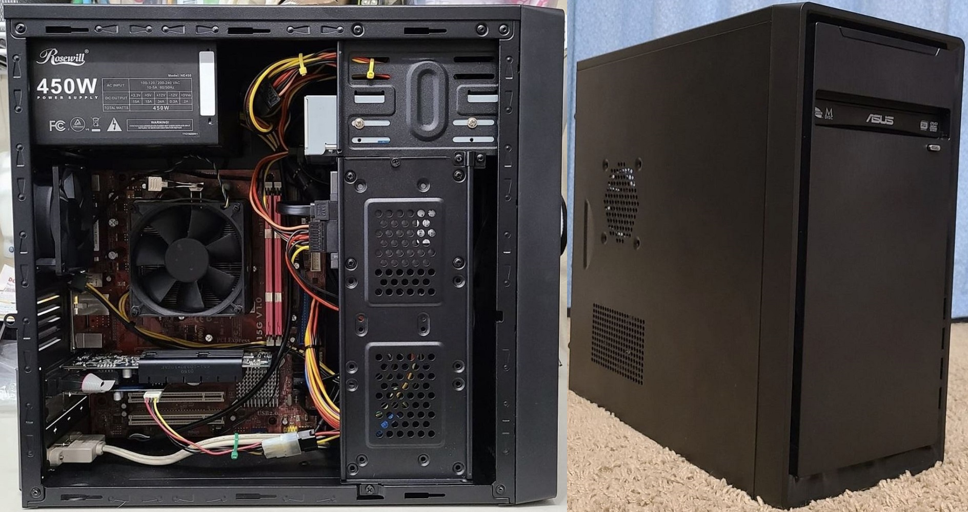

This is my 2008 PC that I use for various things.
Guess it was the power supply. I can't show much, but if allowed, I can show this.
I'd say caps in the PSU failed. I've recapped dozens of SFX PSUs from that era with failed caps that caused the unit to have erratic behavior. Your old PSU would likely work fine with a recap.
The ones that fail are usually the tiny 5x10 sized ones that are stuffed between transformers and on the control circuitry, they cook and dry out.

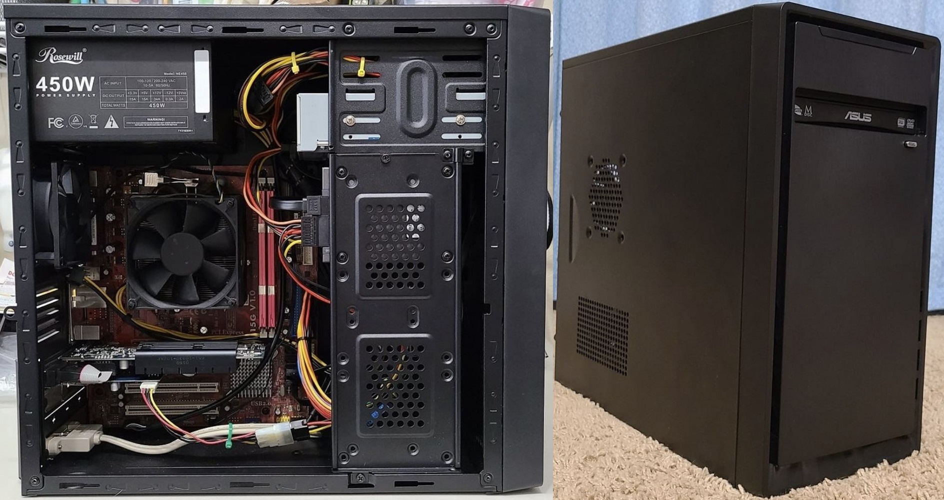

It's been a while but I thought I would come back and put up a picture of what I passed on.
