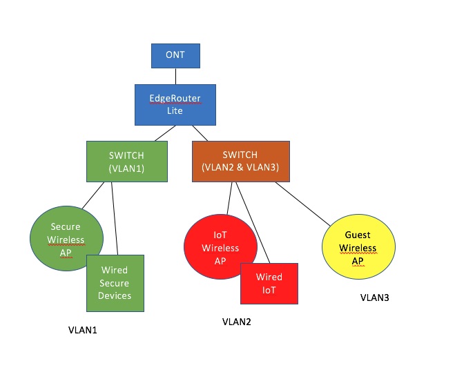

I made a quick diagram of a layout to see if I'm thinking about this right. Does the attached file make sense? I could also reduce some of the switches by getting a router with more zones/ports.
Now I just have to figure out how to implement this as simply as possible (and without costing a fortune).

If on the edge router, you call port 0 WAN, port 1 LAN, and port 2 IOT:
No need for VLANs on LAN. You can just use simple dumb gig switches and a good WAP. The edge router will keep the traffic separate between LAN and IOT if you setup the routes and rules properly.
You could use a VLAN switch for the IOT side to keep the IOT and guest separate.
Might look at some of the Ubiquiti Access points for your wireless. They might play well with the edge lite router and simplify things. I haven't looked at them in a while and never used one of the APs but several folks seem to like them.

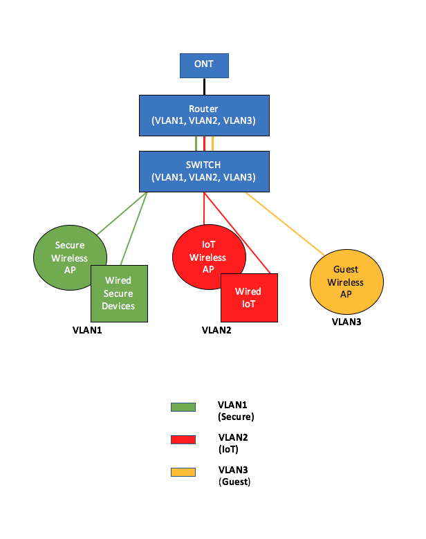

Thanks! I'll look into Ubiquiti. I was originally thinking I'd need to make a trunk connection from the router to a switch with 3 VLANs. Then the switch would separate the 3 VLANs. An updated diagram is attached.
From what you said it sounds like I could just assign a secure LAN to port 1, then use port 2 for guest and IoT (seperated by VLANs).
Anyway, I think that's the route I'll likely go unless another way to secure my guest and IoT devices shows up in the next few weeks. Now I just have to decide which pieces of hardware I'm actually looking at!
