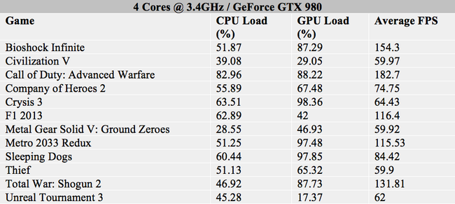

Google to the rescue! This should help you determine whether or not you are CPU bound (again, don't use GW2 for a reference).
Will Your CPU Bottleneck Your Graphics Card? | PC Gamer
yet another PCGAMER crappy and misleading article.. those guys knows nothing about CPU bottleneck, just look at this:
then they boldly say, there's no CPU bottleneck there.. and in every single game tested the GPU is bottlenecked, Thing will be even worse with a 980TI included, they just think that the CPU have to be 100% loaded to mean a bottleneck when in fact a game can be single-thread bottlenecked if a 4 core CPU have one core at 100% load that will mean the overall CPU load will be 25% that still will be bottleneck but they don't even try to explain that.. that's why precisely I hate those guys and that page. always misleading..
Those games at 60 FPS (or very near) look like they have VSYNC enabled or forced enabled by the game engine.
That F1 2013 looks to be CPU bound. Aaand it is a horribly optimised title - F1 2013 - PC Performance Analysis The first paragraph says it all.
Yes, in poorly optimised games a 2600K will suffer much more in single threaded use than a newer CPU will. Yet hopefully DX12 will render that a nearly moot point. Until then, just realise that even with the latest CPU over clocked beyond what is usually possible, those same games will still show a lot of CPU bound problems. Not that you can't get above 60FPS where the 2600k still struggles, but CPU bound the game remains.
