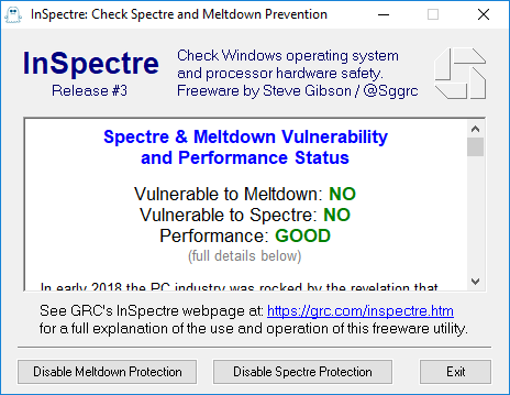

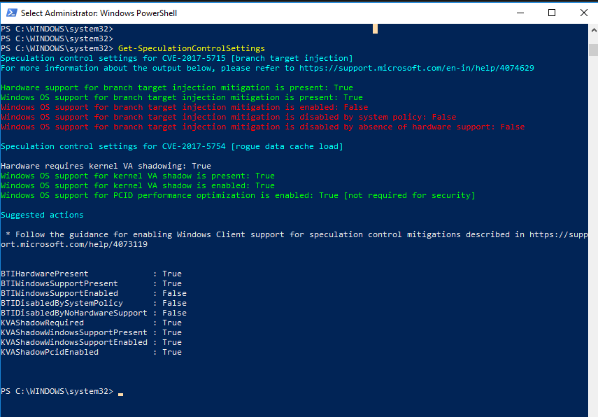

so I'm not sure that GRC tool is all that useful... I had messed about trying to use the VMware driver tool to patch the microcode for my i7-4770K /Z87X-UD3H rig.. blah blah blah... more reading makes it look like this isn't a viable solution as the microcode patch is applied too late in start up for windows to enable the spectre protections..
but: GRC tool happily showed this:: (prior to using the vmware driver tool the GRC app showed this system was vulnerable to spectre)
while running the powershell script gives you the sad truth that you are still sort of boned..

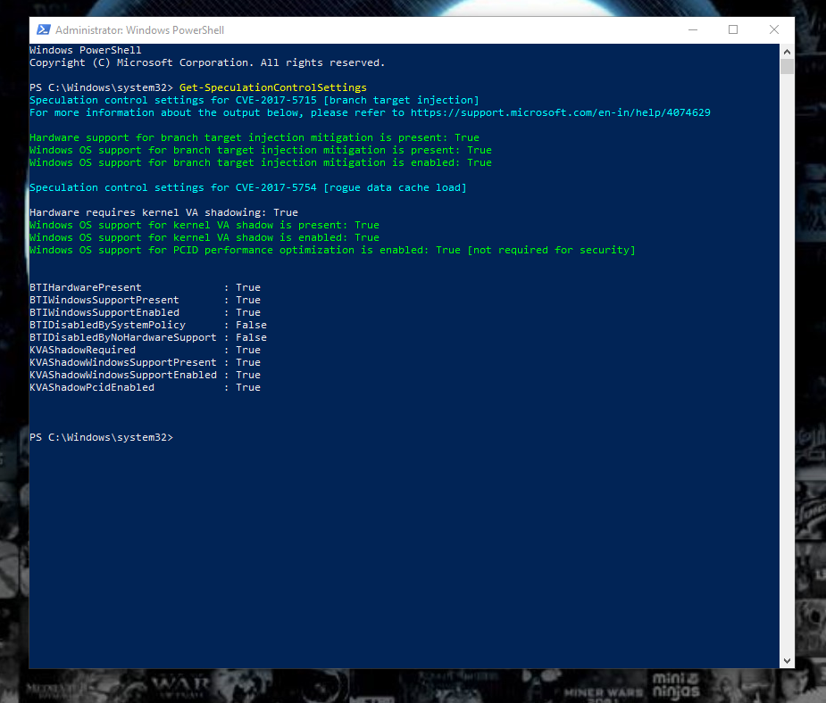

Is this what I should be seeing as far as being so called protected? Starting to get confused!:(
It says my hardware is still vulnerable but the OS is patched. I upgraded to latest bios last night, not sure what else I can do.

so I'm not sure that GRC tool is all that useful... I had messed about trying to use the VMware driver tool to patch the microcode for my i7-4770K /Z87X-UD3H rig.. blah blah blah... more reading makes it look like this isn't a viable solution as the microcode patch is applied to late in start up for windows to enable the spectre protections..

it would be "ok" if it was doing the "same shit" but most recent version #5 still says I'm patched for Spectre (which sadly is incorrect) after attempting to use VMware driver tool to apply microcode update .. which doesn't work because it doesn't load quickly enough for windows to enable the spectre mitigation..
the powershell script does properly report that the spectre mitigation is not active..
