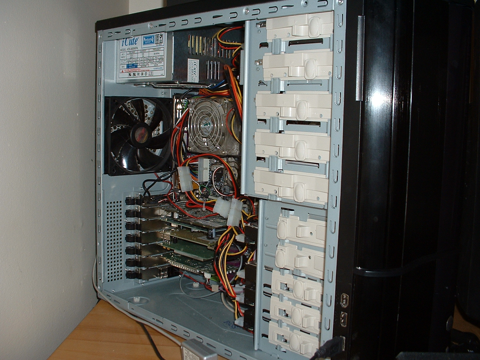

It goes in the same way as the other three. You just have to put it higher than you would think so that the gap between the 4th drive and the 3rd is quite a bit larger than between the other three. Just slide it in and pull the locking plastic back. Photo of 4 drives in the case: http://stfcc.org/bluefox/photos/PC/DSCF0004.JPG
How secure is the drive when its in that way? I know the other drives move around a bit when I transport my tower back and forth from school. It seems that positioning the 4th drive as you did wouldn't be terribly secure.
The drive is on the rails and is rather secure. Shouldn't move even if you move the case frequently.
