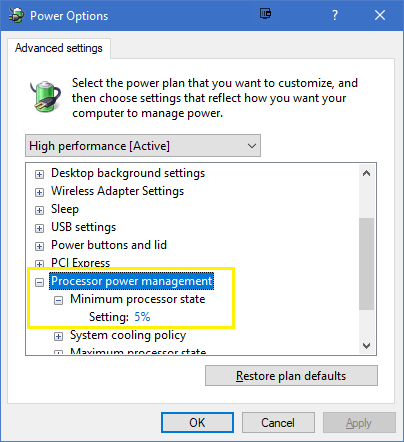

In order to get the reduced clocks at idle you need to make a couple changes in the advanced section of Windows 10 power options
In Windows 10 ver 1803
1. Tap the windows key
2. tap settings
3. tap System
4. tap Power & sleep
5. tap additional power settings
6. next, to High-Performance click on Change plan settings
7. In the resulting dialog click on Change advanced power settings
Change 1
8. scroll down to Processor power management and click the + sign
9. then click the + sign beside Minimum processor state
10. click on setting and enter five which will enable 5% as minimum processor state
Change 2
11. click + sign next to PCI Express
12. click + sign net to Link State Power management
13. tap Settings followed by drop down to select Moderate power savings
14. now click apply followed by OK and close dialog
15. Restart the system and observe the new settings
Problem solved
reason for edit: It appears M$ has changed some aspects of power management making old tweaks no longer viable the work around is illustrated above.
Setting vary on a per system/ hardware config in some cases bios settings may need to cahnge. For some enabling C-Stares and others Intel Speedstep. There are also driver and software confilts again no one size fits all.
For best results select Balanced power option and drill down through your advanced settings to tweak to your liking.
