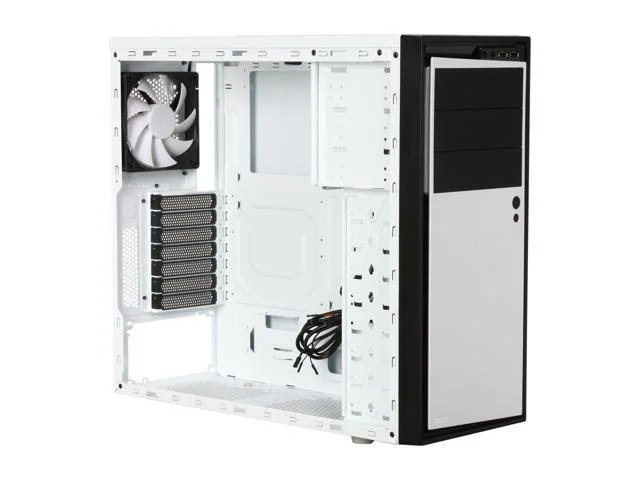

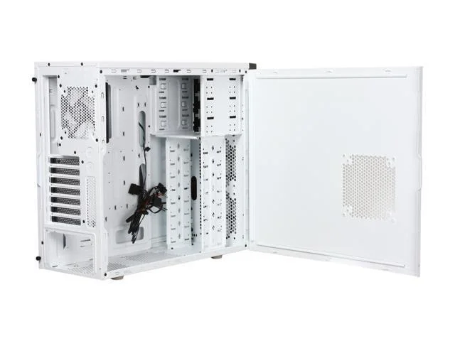

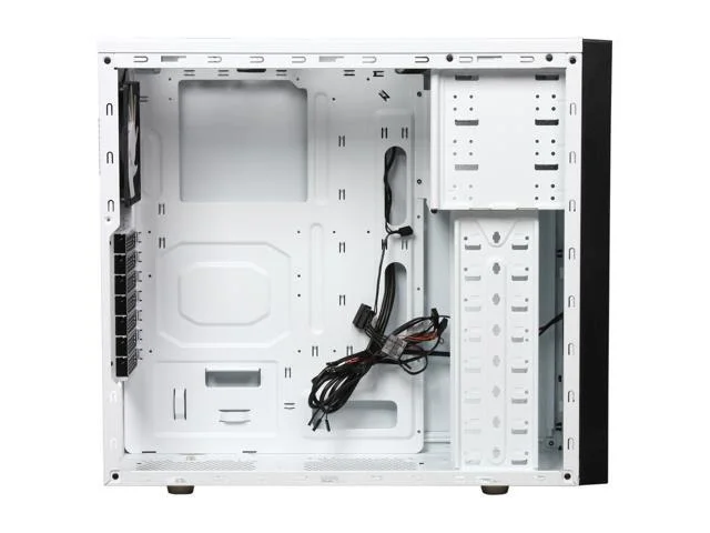

Hey everyone I just bought 5 new Corsair rgb 120 case fans for my old baby NZXT Source 210 (I bought the 3 pack and 2 solo).
Going to set it up like this
Front two 120mm for intake
Rear one 120mm for exhaust
Top two 120mm for exhaust
I decided against using one for the bottom because I didn’t want to mess with the PSU airflow...
I also have a cooler master hyper evo 212 rgb inside blowing directly into the heat sink towards the rear exhaust as recommended.
Anyways I guess first question is does that sound good?
Second question is should I purchase these fan dust air filters for at least the intake in the front because my case doesn't have any and my room gets hella dusty (carpet flooring)?
My PC rests on a stand 🙌
Attaching stock photos of Case below for reference.
Thanks in advance for any suggestions and advice!!

Wouldn't the first top fan just exhaust the cool air before it reaches the CPU/VRM area? I would skip the front top fan.

Thanks! I read that it's just good to have as much air flow as possible so with the two in the front bringing in the cool air I figured it'll circulate everywhere with the three exhaust. Have you experienced otherwise?
It's just my theory. Haven't had a chance to test it. I'm probably overthinking it though. If you still have the fans behind the CPU, they will have to pull air from somewhere.

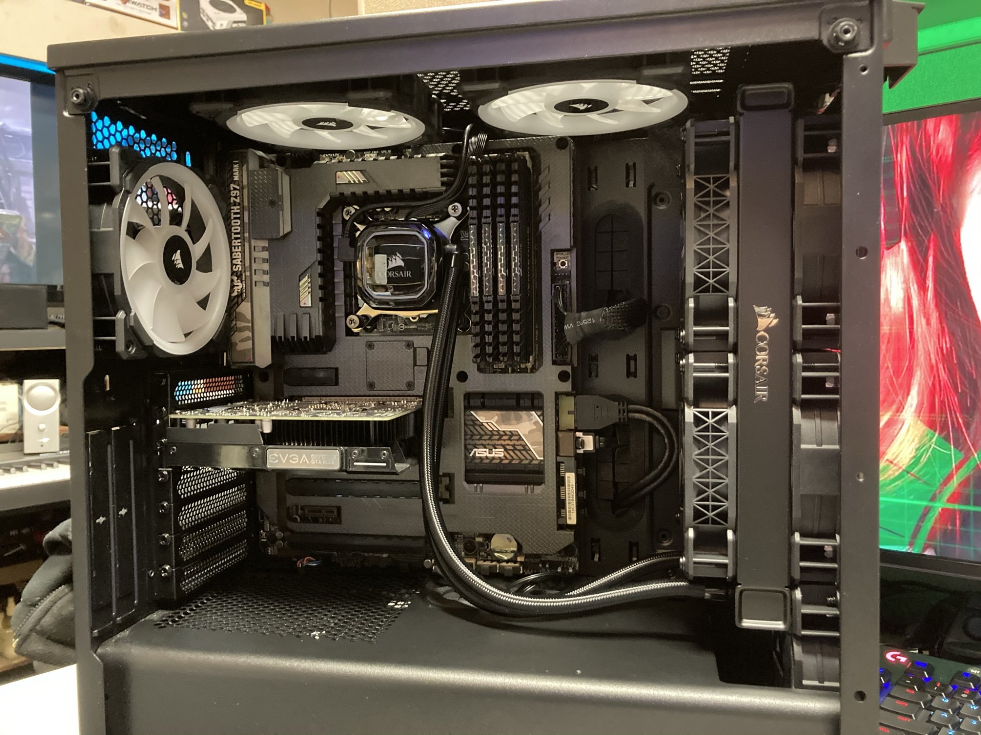

my old setup (took it apart a few hours ago) is setup similar to the way you want except I have an extra fan where your drive bays are.
If you are using a fan controller, you can set the top fans to run a bit slower, and have the front and rear fans run a bit faster so you get more flow through the case without sucking all your cooler air straight out the top.

Filters are nice to have but you have to make sure to clean them often if you are in a dusty environment.
My Corsair 465X has 3 filters, one on the front, one on the bottom for the PSU, and one sitting on top.
I also just changed the setup in that case this morning as a matter of fact.
Stuck my old 4790k setup into it along with a new Corsair H100i RGB Pro XT cooler.

I would also second the comment about skipping the second top fan closer to the front of the case. It does indeed steal the cool intake air away from passing further back into the case and you are setting yourself up for a negative pressure setup with 3x out and 2x in.
I would also second the comment about skipping the second top fan closer to the front of the case. It does indeed steel the cool intake air away from passing further back into the case and you are setting yourself up for a negative pressure setup with 3x out and 2x in.
That's really interesting. If I lower the speed on the second top fan closer to the front would that solve the negative pressure though? Obviously I care about temp more than anything but aesthetically I'd prefer to have two on top if I can make it work and work well.

Well after looking at your case i would day it would be less of a concern than with a case with 3x front where one of the top intakes is higher up on the front so maybe don't worry about it. You can always set it up how you like and then monitor temps and play around with it to see what works best for your particular case.
