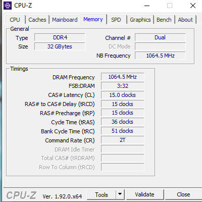

Monitor is an old xstar 1440P 60 hz monitor so no freesync. Windows version 1909
You're running your memory at DDR4-2132, was that on purpose to rule out memory issue? Because I see the XMP profile should have it running at DDR4-3200, plus your North Bridge Frequency is 1:1 with the memory so you're losing out on a lot of performance which might be why your CPU is choking and causing the fps dips. Try enabling XMP profile for your ram if this is the case.

Ryzen's like memory bandwidth upwards of DDR4 3733MHz or DDR4 3800MHz. DDR4 3200MHz is really the standard you should shoot for at a minimum. And as the above post indicates, the Infinity Fabric and memory clocks are linked at a 1:1 ratio unless you go to DDR4 3800MHz or beyond. Memory bandwidth, when dropped that low could absolutely impact your frame rates. I'm not certain this is the only issue here but it's a damn good place to start.
The guys are right about memory speed (turn on XMP) and you also may want to try turning off all boost and lock the CPU speed at 4.2 Ghz as was mentioned (that's how I run my 3600X).

Set ram to xmp as stated above.

XMP may have solved the issue. For some reason I kept turing it on and it would not stick. It finally did. I'm running through some COD and BL3 today will let you know results. And yes the new monitor is next on the list, lol right after a new Macbook for my son's freshman year at college and new furniture for my daughter UGH!! :)
if it was turning off it's possible it's not completely stable or older bios issues so every time it fails the memory training on boot it resets(should attempt it 3 times before resetting to 2166). so you might want to keep an eye on that if you happen to notice it taking longer than normal to boot.
If it doesn't stick, try setting XMP to on THEN manually increasing the voltage. Most XMP profiles attempt 1.35, but most RAM should be good even up to 1.4V.
There are some modules that seem to want a bit more than 1.35v to run stable with their XMP values. Additionally, some motherboards run their memory voltages at lower values than specified. For example, I've seen motherboards show an actual memory voltage of 1.345v or something to that effect. When you see that, you may need to adjust it higher to compensate for that.
I've had to do this for every build I've had since DDR2. This most recent one I had to increase the motherboard setting to 1.38V for the memory to actually run at 1.35V.
As you know, I have tested and do currently test lots of motherboards. It depends on both the motherboard and the RAM. I've been able to get away with default settings on most boards. However, some RAM, such as Corsair RAM likes a little additional voltage to run right. My G.Skill and other modules are more forgiving in this regard.
Is there a way to test what the actual voltage is that your RAM is getting? Or does the setting in the motherboard determine the sensor reading? I have my RAM set to 1.35 in the BIOS but according to HWinfo64 it's reading 1.36v So I'm guessing the latter is more accurate?
The sensing capability comes from the voltage controller. However, some motherboards do have voltage check points for you to read this information directly. Typically, this is only available on more expensive models. And setting to 1.35v does not preclude a slightly higher reading either. Your voltages are fine so long as they are within roughly 10% +/- of the setting.
