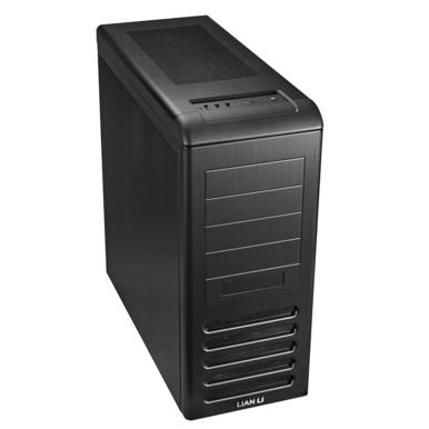

Your problem is definitely the 7FNWX, the single 140mm intake just kills it's cooling ability. I had one with an AMD 955 BE system that I could never keep cool at 4 Ghz. Switched it to a LIAN LI PC-K65 and it ran all day long for years at 4 Ghz.

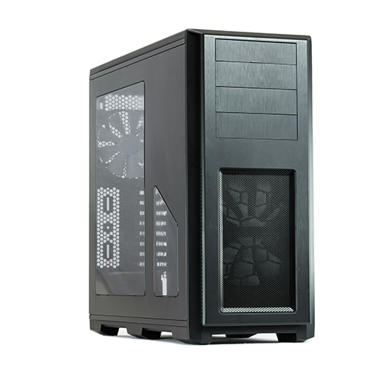

Personally, my next case will be the Phantek Enthoo Pro,
So many options and I really like the idea of being able to tear it almost all the way apart.

In order to add an intake I bought this:
lian-li-lian-li-bz-502-intake-cooling-kit-black-lian-li-bz-502-intake-cooling-kit-aluminium-front-panel-use-3x-525-with-1x-120mm.jpg
I hope that this will help me solving the "intake" problem.
The problem is that the two gtx980 ti produces really a lot of heat and I don't know how to exhaust it without passing the hot air through a radiator.
Also with that optional the two fans will me mounted as exhaust and the hot air will pass through the rad.
