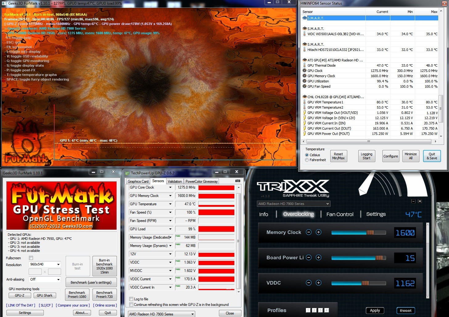

Here is my Sapphire HD7950 950mhz edition set at 1.162v with TRIXX(which I think is off +.04v) running Furmark for 40 minutes.
Ambient temperature of 29.5C.
I used Trixx to set voltage but I think the Trixx software may be off a little on the voltage settings as GPU-Z and HWinfo64 pick up sensor reading voltage of around 1.06v under load and 1.128v without any load. Looks like a voltage drop of around .06v under load and Trixx is off by around +.04v.

I have the Sapphire 950mhz Edition HD7950 which is built on a reference HD7970 PCB. It's one of the newest HD7950s around, totally compatible with reference HD7970 water blocks. Amazon is selling them for $389.99 right now.

Not sure how much voltage your card can handle. Could you do me a favor and run HWinfo64 and monitor your temps during furmark load? I'm curious as to how hot your VRM and GPU is getting under load.
Most VRM's are rated for around 120C but I don't think it is a good idea to run them that hot and I believe the heat heats up the PCB and effects other over all conductiveness of PCB for stability. Cooler is always better IMO.

Running Seasonic 760X which looks great on my 12v readings but my 3.5v readings are dipping as low as 3v. 500mv seems like way too much of a dip.
Ambient temperature 23.6C
Your block is doing a great job at cooling your VRMs. I did same test with your setting for the first 5 minutes then I tapered voltage down to 1.181 for another 5 minutes. You can see how the temps came down just a little. Looking at your 12v readings it looks like it is dipping and that might be why your vrms on your card are putting out alot less current. Extra current on my card VRMS is probably causing them to get extra hot as well.

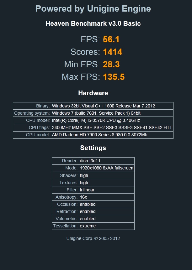

Any of you guys able to actually pass Unigine Heaven loops at max details for 60 minutes or so? I don't think anyone even uses Furmark anymore. Would like to see if these overclocks are stable in a current stress test.
I have gamed UT3, BF3 and Crysis 2 for hours at these settings without any problems. I use Furmark to test because it is easy to run and does create a nice load and heat.
I think you had a decent HD7950 but not that great of a card. Over clocking with any card is kind of luck of the draw on over clocks. Also our cards are water cooled.
Heaven demo is free and provides a nice stability tool. Why not try it? I've seen many high clock speeds in the games you have listed but won't pass Heaven for 30-60 minutes. That may or may not matter to you but I think Heaven is the standard for which most people are stability testing right now, kind of hard to compare stable speeds to others when not using the same stability tools. Give it a try, its not like it costs you anything.

No benches, just run Heaven at DX11, highest resolution your monitor supports, 8xAA, 16xAF, Extreme Tesselation. If it passes 60 minutes of that, its probably stable in anything. Its just difficult to compare similar overclocks when most people are using Heaven these days, and honestly, everyone should be, so when I see other clock speeds using other stability tests, its just hard to see if it would be the same using the Heaven standard.
I've got time to do the 1 hour Heaven run.
Just ran the benchmark mode at 1600/1300 1.22V under load.
Will keep the same settings and run it for 1 hour.
Will post screen shot of HWinfo64 so you can see how the card reacts to the load for an hour.
Over 2 hours of running Heaven. Stable.

I ran the Heaven loops double the time you requested just so that you can see that the card is stable and I posted the HWinfo64 sensor info so everyone can check out the sensor readings under load. My card is water cooled with a Swiftech MCW82-7900 gpu only block using the stock PCB heat sink. My Raven RV02 case has good air flow which I think helps keep the card cool.
That's why everyone is using Heaven, its the best tool available right now for checking overclocks.
