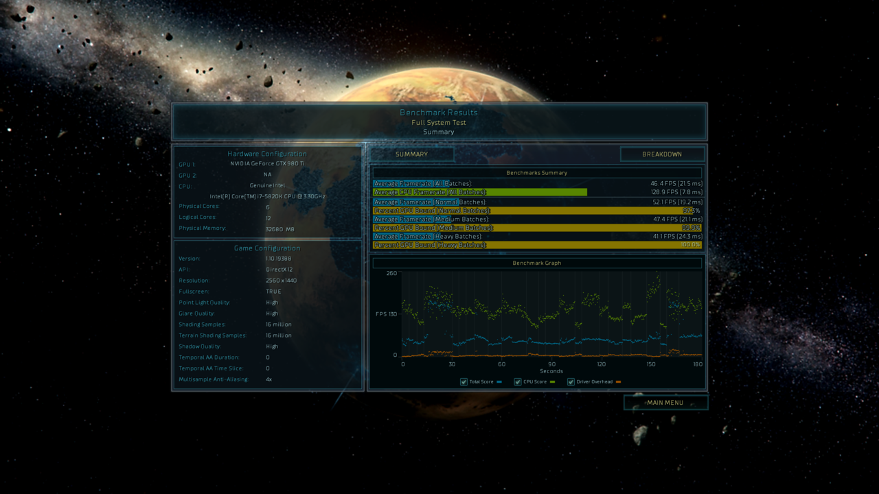

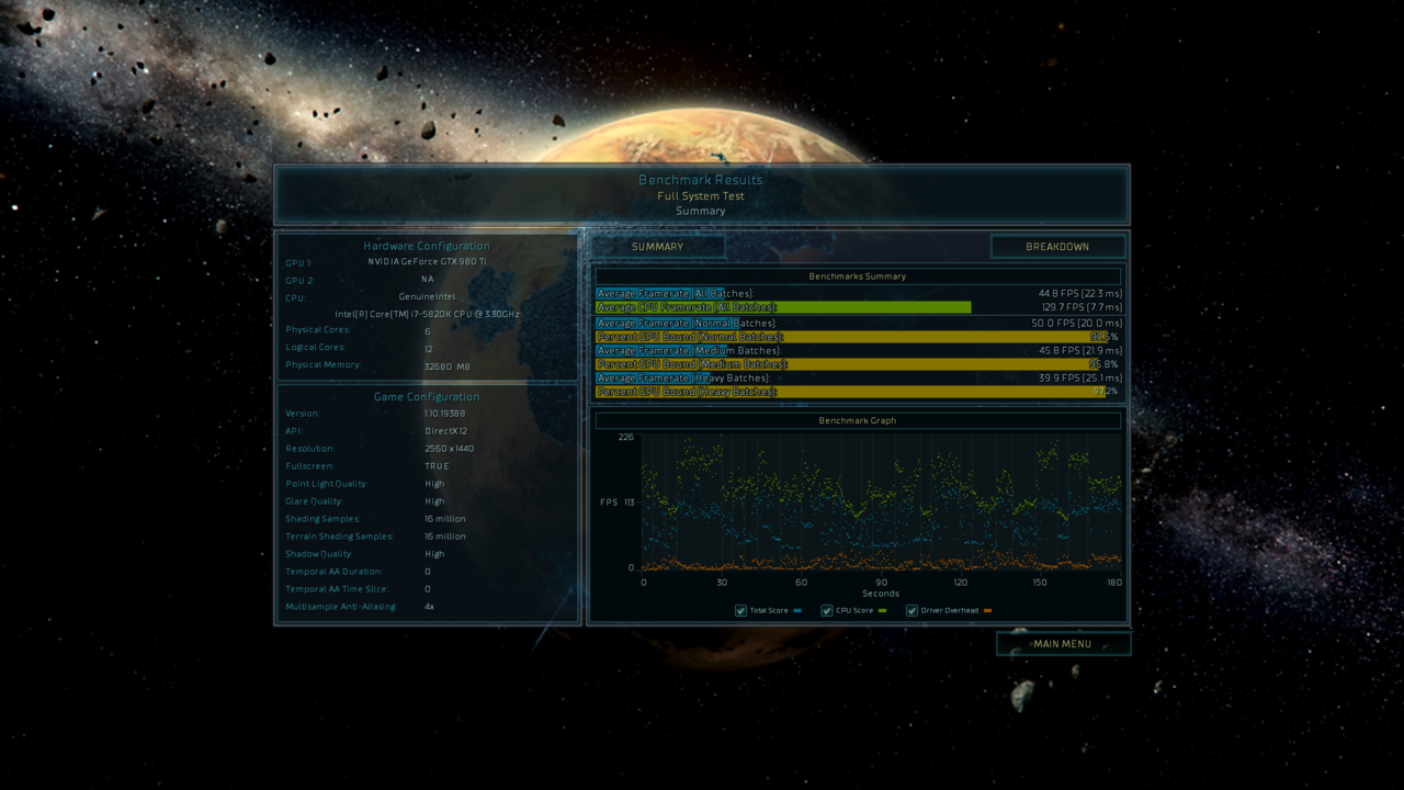

Gtx 1080 benchmarked
I'm quite inclined to believe these AotS benchmarks are true; more so than 3dmark honestly

Now I'm on 365.10 and the newest version of the game
Async ON
Async OFF
