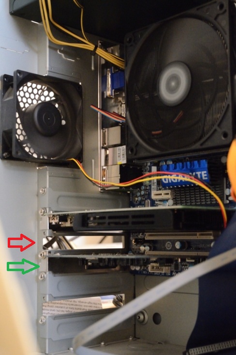

Just installed a GT430 (the EVGA dual DVI version).
Only one monitor currently attached.
At 'idle' (i.e. - not gaming or watching a movie), CPUID HW Monitor indicates the temp in the mid-to-high 50's (54-57°C as I type this).
Jumps to high 60's when watching a movie.
The fan stays at 65% in either case.
In comparison, the System temp is 37°C, and the CPU (a Phenom II X6 1090T) is 36°C. Ambient temp is, oh, 75-80°F.
Bottom line -- the GT430 temps strike me as high.
I'd welcome knowing what's typical / whether I may have a faulty card.

Those temps are just fine. Generally budget cards like the 430 have less than optimal cooling to save on cost. Either way 60s is normal.
Sounds a bit high, but you should be alright. Most of those sorts of cards idle in the 50s or 60s.

After moving the Delta44 card one slot over to give the GT430
room to breathe, temperatures dropped ~20°C at idle, and >20°C
under load (maxing at 77°C after 10 minutes of furmark).
[Who'd have thunk that rendering a fuzzy doughnut could be so demanding?]
Here's a photo showing where the Delta44 was (red arrow) and is (green):
Live and learn.
