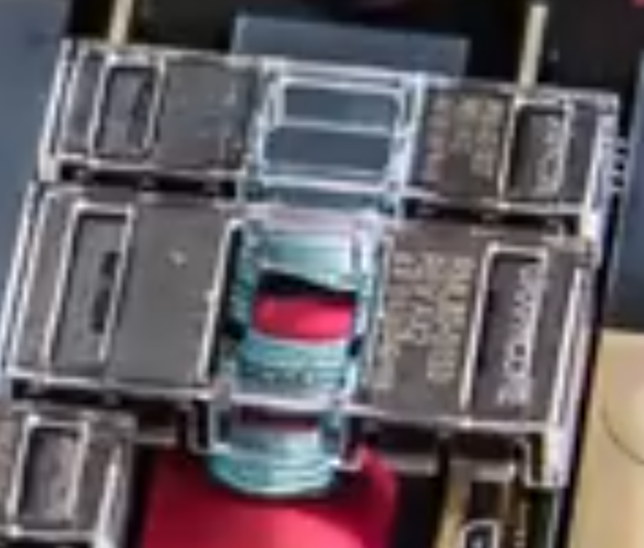

It looks like the 8654 standard is about 3 pins longer than the connection on the card. Its looking like a proprietary cable at this point. Shame, since Graphcore won't work with any of us. Oh well, no interconnects for me!
Contemplating getting an oscilloscope to map a pinout myself to make a custom cable, because I'm not the type to give up. However, this idea will have to take a back seat to my main project. If I ever get around to making a pinout map for a custom cable, I will report back here.
This is the picture of the interconnects from Graphcore. If anyone ends up with any, I'm interested in purchasing.
Hey, I'm right there with you. I don't give up, and I know I will find some. When I do, how many are you needing? If you find any, please do the same for me. I attached a picture I found. I wish graphcore would just say anything at this point. Oh well, we will figure it out.
