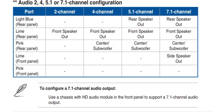

Appreciate it, and that's what I thought as well. There are 3 jacks (different colors than what my previous MB) but when I plugged them in, it still only utilized the front L/R. Even on the description on this ASUS home page for this MB, it states, enjoy stereo sound.
Maybe there is something I need to change in the BIOS? Day 1 on having this computer so i'm still trouble shooting. Hopefully can figure this out :)
From the manual. Unless I am missing something.
Asus Prime Wi-Fi

but as Dar just showed, it should have it, most do these days. on the off chance it doesnt, see if your speakers have spdif and if the board has the option to add it via a header(mine do).

all you should need to do is install the drivers, connect the speaker jacks correctly, and set it to 5.1 in the sound properties.
I think I may have got it. Thx to all folks here for your help. This audio driver may have done the trick. Still testing but this would resolve alot for me.
