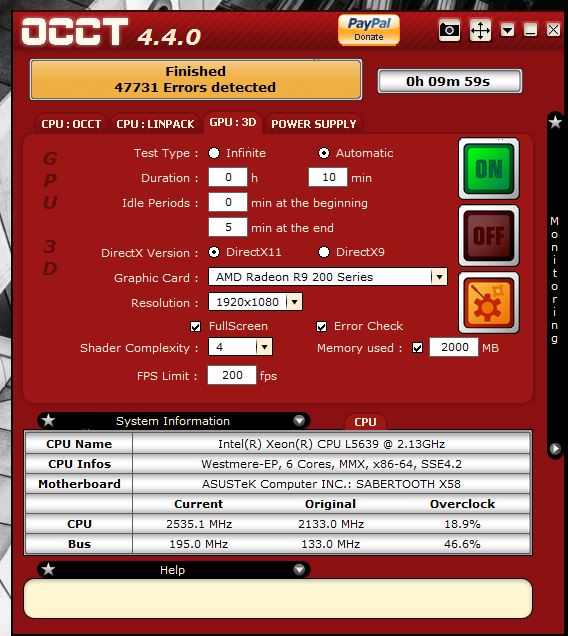

I ran FurMark and temps never got over 70c. I then fired up OCCT and enabled error checking. This is what I got:

So, I'm guessing that I got a DOA card. Should I send it back, or is there something else I should be doing? This is the first ATI/AMD card I have owned in 10 years and so far it has not been a great experience. Thanks for any help!

I tried both of these benchmarks. In both I get artifacts.

Any recent card should be fine with Furmark. OP's card sounds defective with artifacts on desktop. The OCCT vram test has been buggy in the past.
