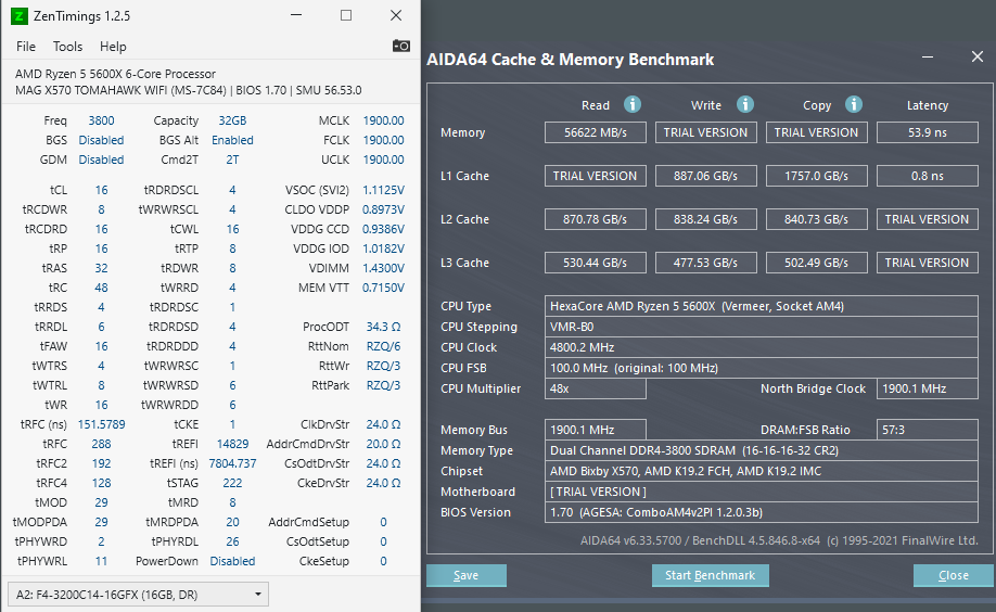

Final settings for RAM for now. Probably took more work than it was worth, but it was a fun journey.
did you happen to do any before/after tests to compare, see if its worth it?
Compared to stock, XMP? I don't think I even benched stock settings, XMP 3200 14-14-14-14-34 was ~58ns, iirc. Early 3600 stable averaged ~57ns, while earlier 3800 revisions were closer to ~55ns. Like I mentioned earlier the kit is an older b-die revision (type RC) on raw card revision B1, so it's got it's issues; what hurt me the most was heat instability when lowering primaries at higher frequencies, may revisit if I ever upgrade cooling solution, but it'll be a bit of work to tighten up.
Later testing moved to ABSOLUT@anta777 config on TM5. A bit more brutal and took about 50min longer with suggested .cfg changes for 12 thread CPUs, but it may also need more than the standard 3 cycles as well. When nearing stable it always seemed to pass the first round of testing, but not a second round after start up (failures occurred near the end of cycle 3).
The toughest settings to work with were cad_bus since there are some standard combos that work well (24-20-24-24, 40-20-30-20, 60-20-30-20, etc.), but the closer you get to the edge of stable frequency, timings, and voltage the more you have to hone in on looking for settings unique to your individual setup which is a bit too time consuming for me.
Best not to, it ruins the fun learning your hours of tweaking produced a 1% increase in performance. Best to just assume it's awesome.
I'm not sure how a 8~9% latency improvement translates to realworld performance, but I'm going to assume it's about as good as upgrading from a 120hz monitor to 144hz :ROFLMAO:
edit: footnote about the TM5 ABSOLUT profile - it doesn't seem to pick up on imc related instability, so make sure to do a full suite of RAM related testing when finalizing results.

set pbo to enabled (auto = disabled), with auto for everything else. increase power package limit to max recommend for 5600,
see what that does.
if you want to set manual numbers for PPT/TDC/EDC, i would first do some reading on oc guides for ryzen 5xxx, as there are certain things like one should be +xx% higher,
above certain levels, gains arent worth it (vari for diff cpus), and thats completely ignoring chip sample lottery.
much easier to check if your IF can do 1900 and run some 3800c16 on bdie or similar, with tweaked secondaries.
unless you have some serious money invested on the cooling side, i would keep pbo to do as last thing, after tweaking bus/ram/gpu,
as the gains tend to be smaller than doing any of the other things i mentioned, and basically a minor attempt to make up for the fact that amd (intel) now oc their cpus from the start (boost clocks),
and the avg tweaker not really gaining much more than ~5% compared to earlier days, short of some binned chip in a pre-build unit...
