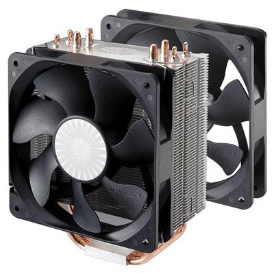

In a push/pull configuration both of the fans blow air in the same direction. It's just that one is pushing air into the heatsink, and the other is pulling air out of the heatsink.
Here's the best picture ever. Please notice that both of the fans are blowing air in the same direction. http://ecx.images-amazon.com/images/I/51d2LSQQJHL._SS400_.jpg
Got it, thanks, those helped out a lot. As you say, pictures are really worth a thousand words. :D
Does it matter when doing push/pull if the push fan is on the outside of the case and pull on the inside or vice versa? Didn't think it really mattered so long as they are like in the picture in the links.
Beyond what aesthetically looks good, it doesn't matter as long as you have a good seal. To get the most out of a push/pull configuration, you want to make sure both fans are "sealed" against the radiator shroud so that there are no air leaks between the fan frame and radiator shroud. That said, push/pull configurations are largely redundant and really only add noise to a setup unless you have a very dense fin array.
