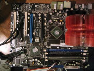

EVGA 680i problems possibly identified!
Ooh, now that's some ugly lookin' stuff right there. Probably doing more harm than good, actually.

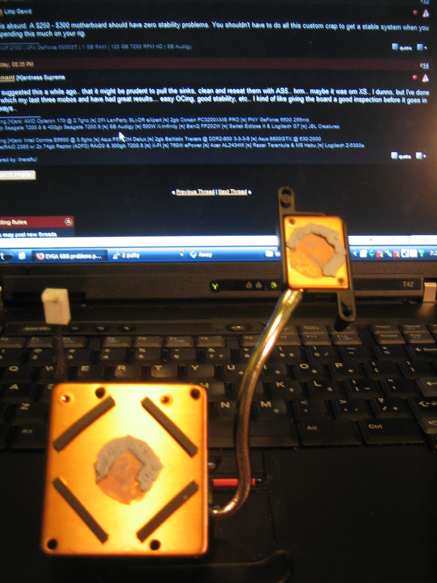

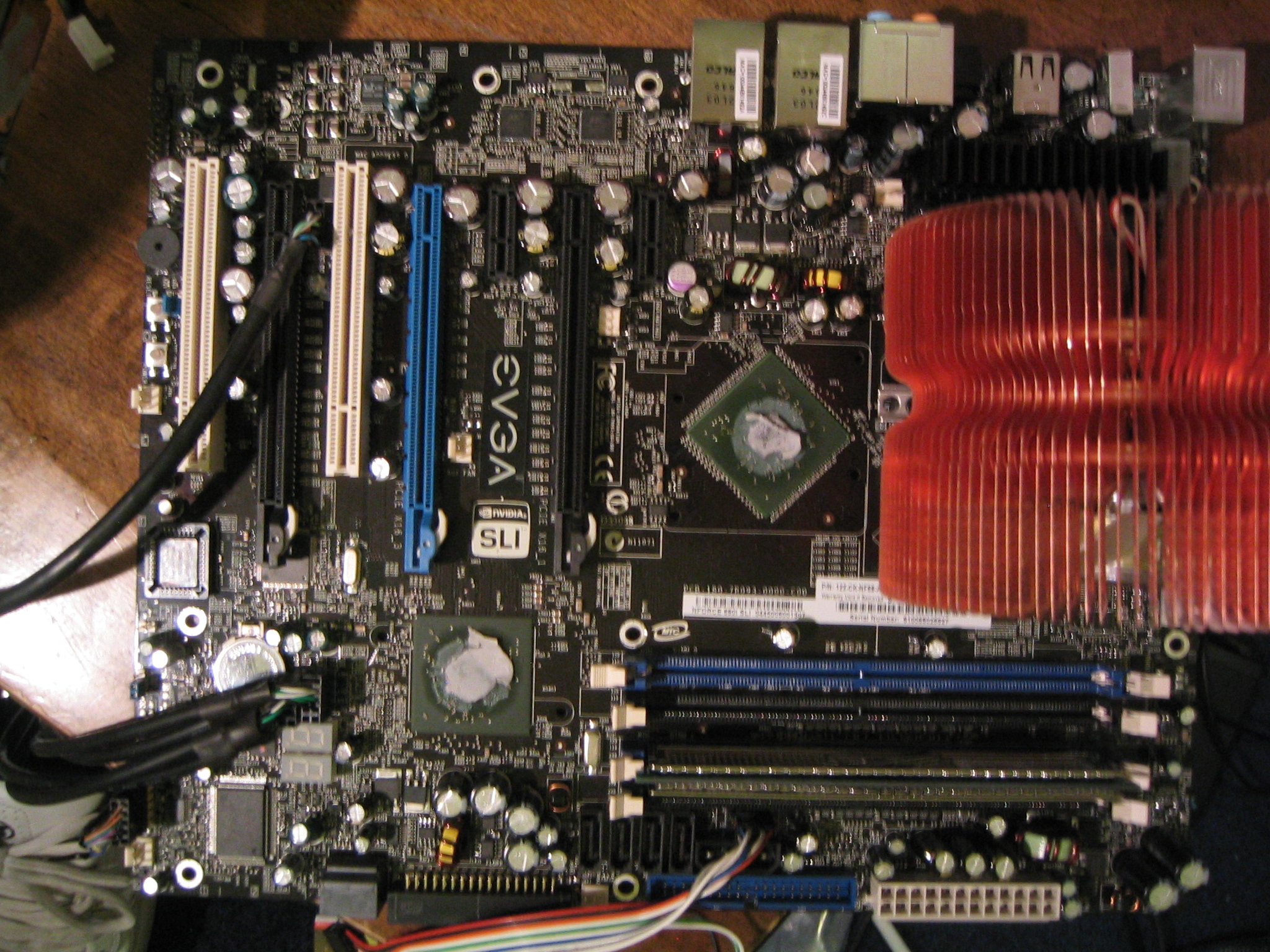

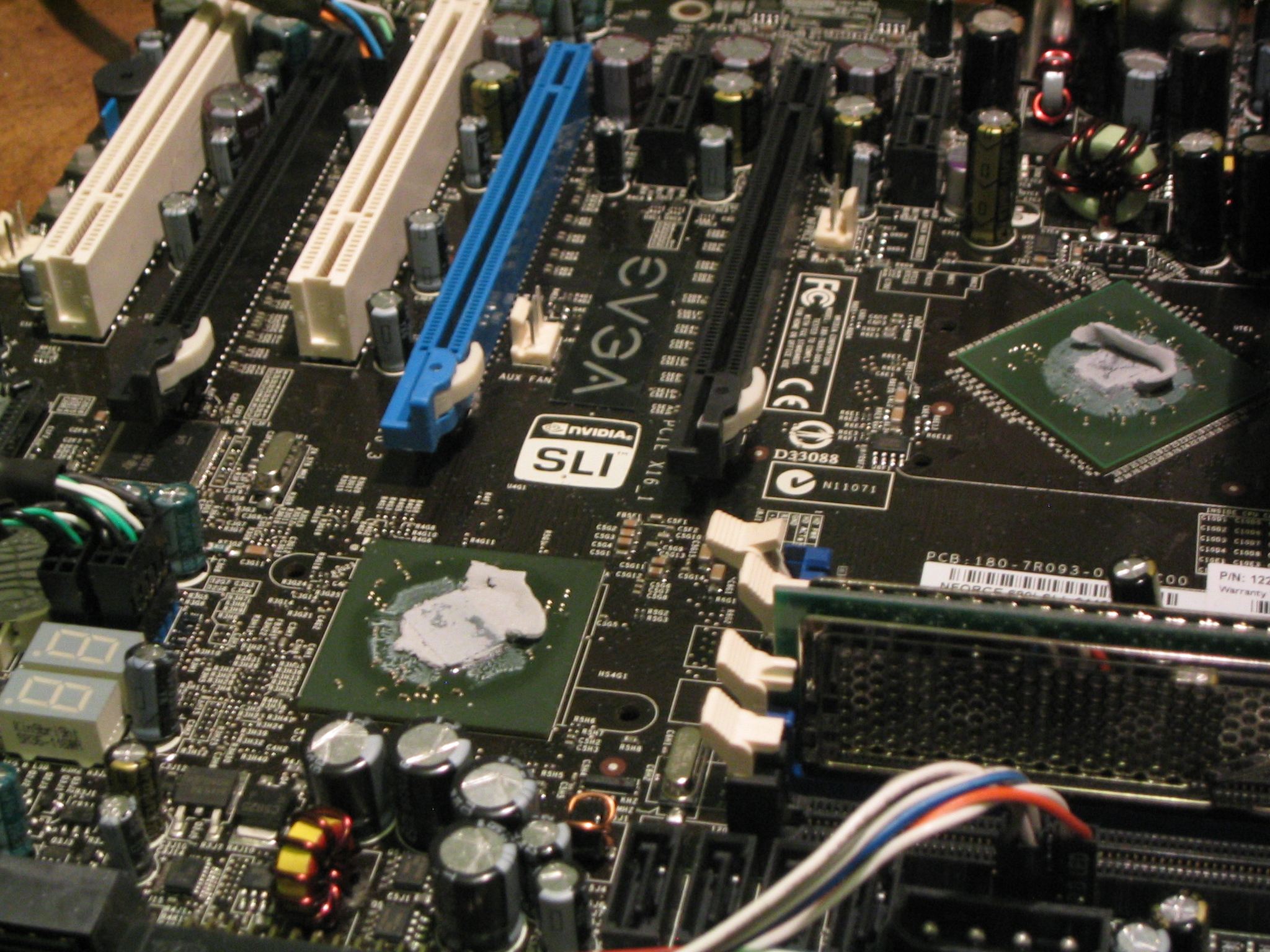

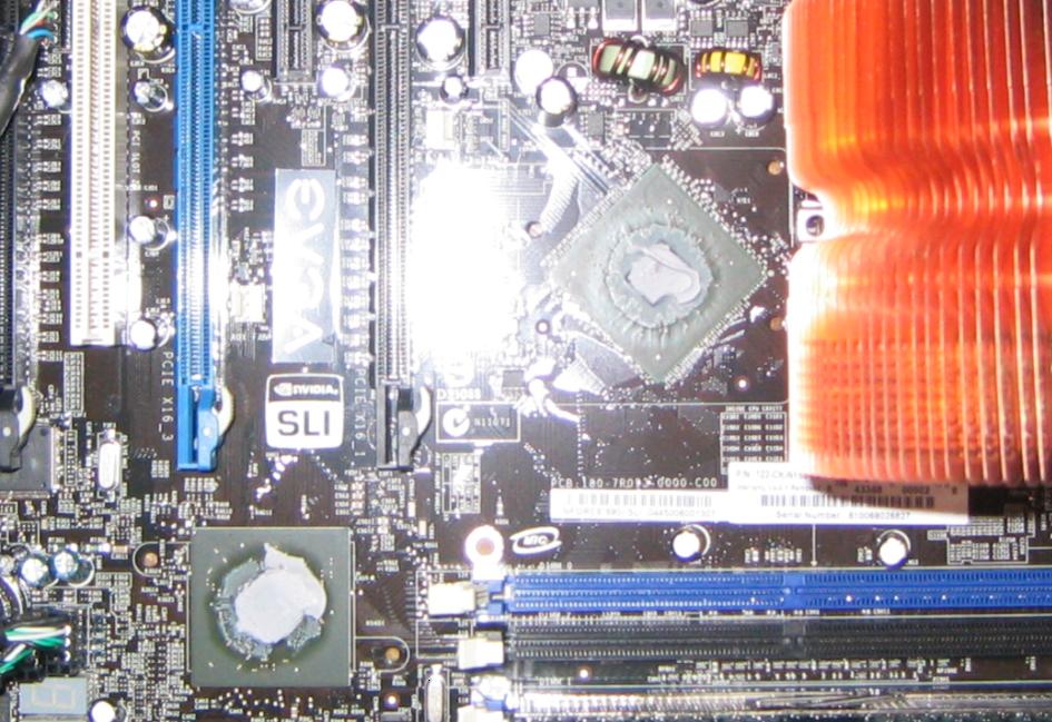

After reading about how pretty much everyone has found the grey gunk where thermal compound should be on this board, I went ahead and took my 680i apart and cleaned up the "puddy" as best I could and applied some AS. Here are some pictures I took (click the images for the hi-res version if you dare..be patient though it's hosted on my DSL ;)):
Pretty nasty stuff. It is the consistency of partially dried putty that is used on sheetrock. I've only had the motherboard running for about 3 days and already there is some darkening in the silicone on the northbridge. I'm going to RMA this mobeezee for sure (at 9am PST tomorrow, 888-881-EVGA (3842) option 2), and then I will apply thermal compound on the next 680i before it even boots up once (this mo also has a dead fan header, which I will use as the reason for the RMA).
