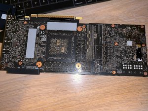

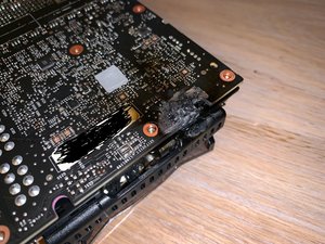

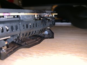

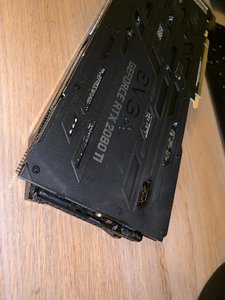

I was just doing some web browsing, wasn't even doing anything else at the time. Everything in its stock form, never even opened it before.
Suddenly, the PC just turned off itself. I was wondering what went wrong by looking into the side panel, then suddenly graphic card starts to shoot flame at the edge of PCB.
Scared the shit out of me since my kid was right around it when it shoots flame. Haven't tried to turn the PC back on to check if the rest is fine, since I don't have extra GPU with me.
IMG_0517.jpeg IMG_0518.jpeg IMG_0519.jpeg IMG_0520.jpeg IMG_0528.jpeg IMG_0534.jpeg

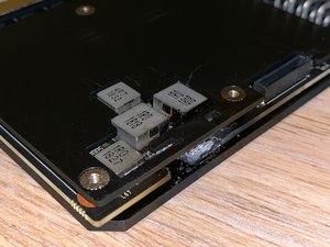

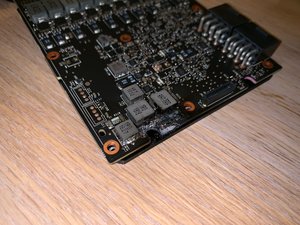

That's crazy! I'm not entirely surprised by it, since I know how hot those chokes can get... but I AM curious about a couple things, if anyone knows the answer?
Is it the Fan Header that melted? It kinda looks that way to me in this pic, as there looks to be at least 3 wires and heatshrink tubing:
Then in this pic... What I've traced in red, is that some sort of metal backplate, or just the copper ground layer that is now visible?
Originally I was thinking it was a sticker due to the text in blue, and that is why it caught fire in the first place; however... No, that's definitely just a resistor, same as on the other side:
To my untrained eye, it looked like it's the fan header and that they routed the wires between those two 1RD 1818 chokes.
As for why it would've caught fire under a simple load like browsing the internet (unless it was YouPorn YouTube vids?), the only thing I can speculate is that the heatshrink tubing was the "good" kind that has a glue in it, except in this instance it's that glue which ended up catching fire. I've used that kind of heatshrink before, but I don't have any experience as to it's resistance to prolonged high heat like what those chokes can produce (and I don't know if those specific chokes are really going to, given their location, both far from power phases and at the edge of the board with decent airflow). The glue in those obviously doesn't take much to melt and "flow", as I've just used a cig lighter, but I also only expose it all to heat long enough to shrink and ooze the glue a little. Exposure to continual heat could easily cause it to break down and dry out in which *poof*; or break down and emit a flammable gas or resin, in which *poof*.
