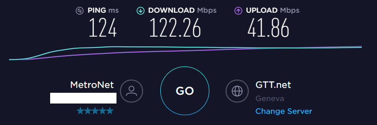

I just use 2xR7000s routers in my house for wifi N/AC. 1 in the basement on the "west side" and 1 in my bedroom on the top floor in the Center/Southside. It works pretty well. Labeled them NSA Sucks 1/2 5g and NSA Sucks 1/2 2.4G.
Here are some examples I get with Metronet ^-^
