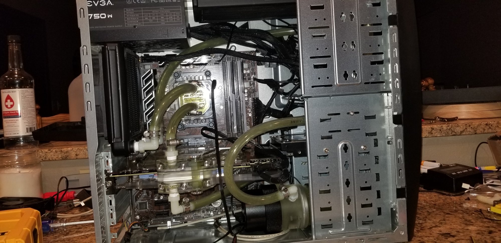

Got everything swapped into the other case last night along with all the radiators and tubing and EVERYTHING...
So I start filling the loop with coolant and working to bleed the air out. Then I notice coolant is seeping from the bottom of the pump. Got the pump back out and I can not get it to stop the leak. No clue where it is even coming from; o-ring looks good, everything is seated properly, but yet a slight drip remains.

What kind of pump, is it a pump res combo?
I just got a barrow D5 with the reservoir that screws on.
To which, that does bring up an interesting troubleshooting step...connect a reservoir direct to the pump to verify where the leak originates.
I would check to make sure one of your fittings is not cross threaded and not properly sitting.

You may have mess with it a little to get the o-ring to seat properly. If they didn't tighten it enough or over tightened it. Both can cause it to seep a little.
Well, I think I finally got it all crammed in.
What a pita...no space to get a good spot to fill it with fluid. No space for anything it feels like.
Tomorrow I'll see if it actually boots...maybe run a test or something.
