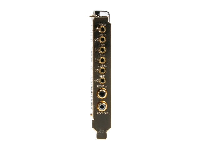

ok i got my sub..i cant get it to work on my d2x
is there a setting in the xonar application i need to set up? i have audio channels set to 2 channels, PCM 192khz
i got it to work when i set it to 5.1. i have the phase set at 0 but what should i have the low filter Hz to?
Your sub should work when your sound card is set to 2.1. Assuming your speakers are within 3 feet, set your crossover to 80hz
well there isnt a "2.1" setting it has audio channel which is set to 2 channels and analog out which i set to 5.1 to get the sub to work
There should be a knob on the back that you turn to where its close or slightly above where you think 80hz would be. As for 2.1, most sound cards only do stereo so you would need to use the line levels for that probably, not sure how you'd hook that upto the maudio speakers.
ok so as far as the HZ go i shoould set it to 80hz?
the knob is under the volume
You can see the 80hz at the 11 oclock position, you need it a smidge above there. Just putting it at 12 oclock would be 100hz area which wouldn't be too bad either.
still cant get the sub to work unless the xonar is set to 5.1 analog out
Yeah. 2ch = only the AV30. Because... that is the definition of 2ch. 2 speakers. The .1 of 2.1 or 5.1 is the subwoofer being added to the system. Therefore, you need to set the software to 5.1 to get the sub working because you clearly don't have a 2.1 setting.
