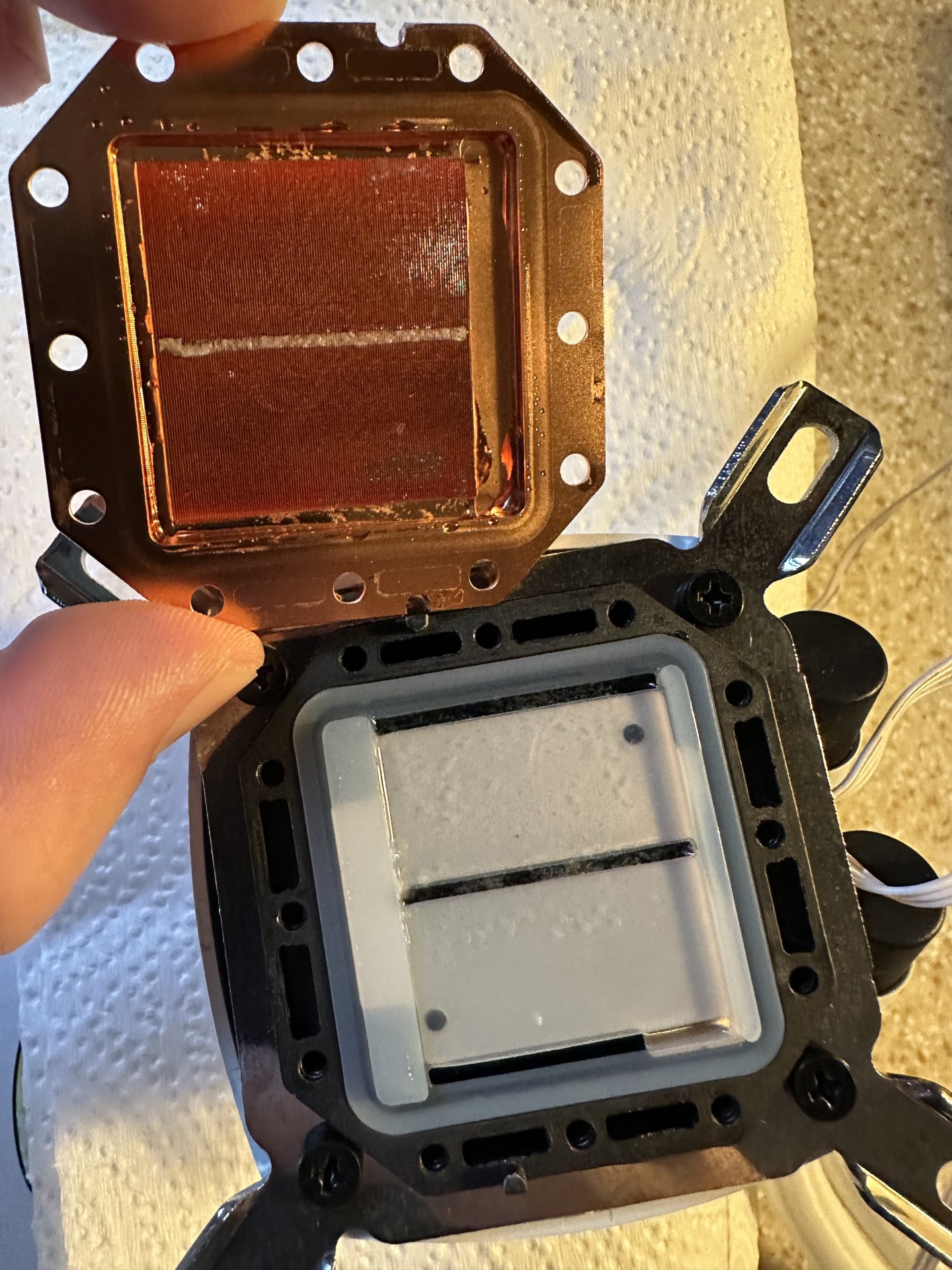

I had this EK Nucleus expensive 360 AIO I bought like 3 years ago, the RGB all died randomly so they sent me a new one. It sat in the closet for a while because I had already replaced it.

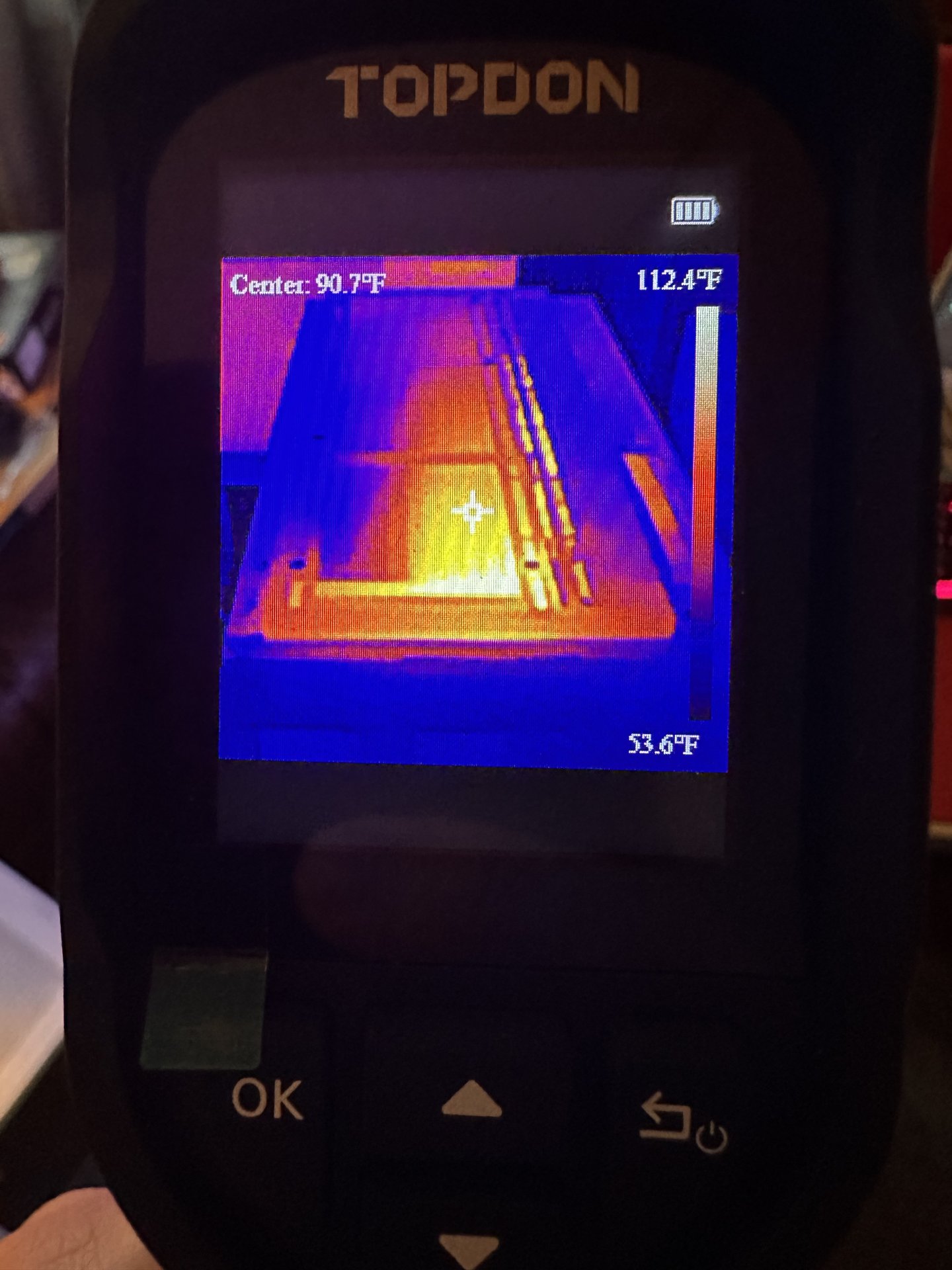

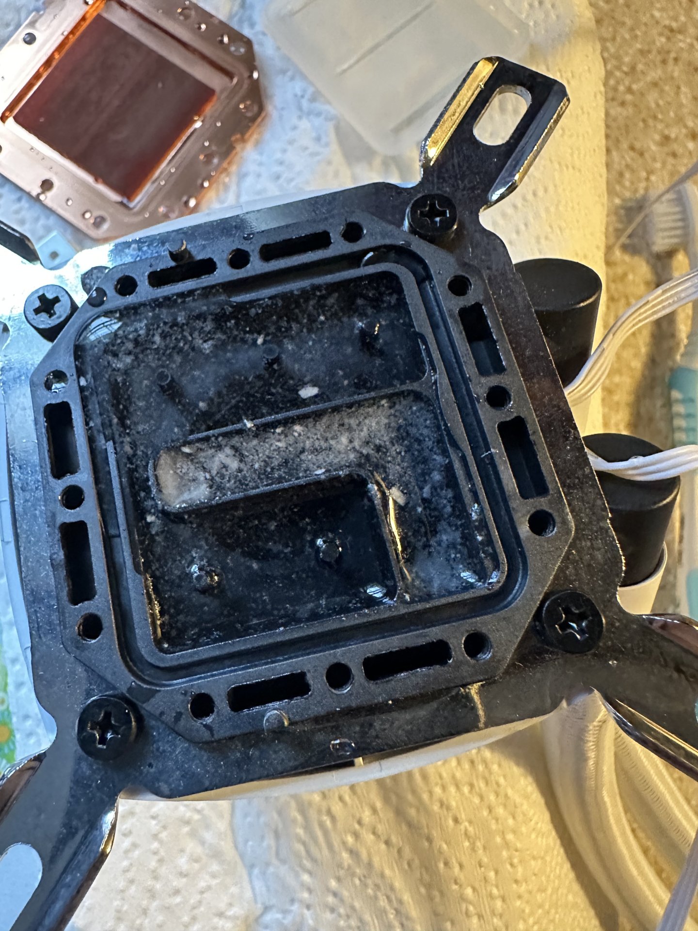

Fast forward to a few months ago and I built a rig for a friend with a 13700K and used the brand new replacement to save him some money, well he brought it back to me due to high temps this week. I checked it with my thermal camera and there was definitely a clog in the radiator so I pulled it apart, I can’t believe we’re still doing this in 2026 after all those asetek failures with MSI and other brands a few years back.
That's pretty gross for a closed loop system. What even is that? Plastic flakes? Or a slime of some kind?
I haven't touched EK products in years. I think I still have an AM4 waterblock in it's box still from 2018.
That's a shame. Have you let EK know, is there still a warranty claim to be made?
