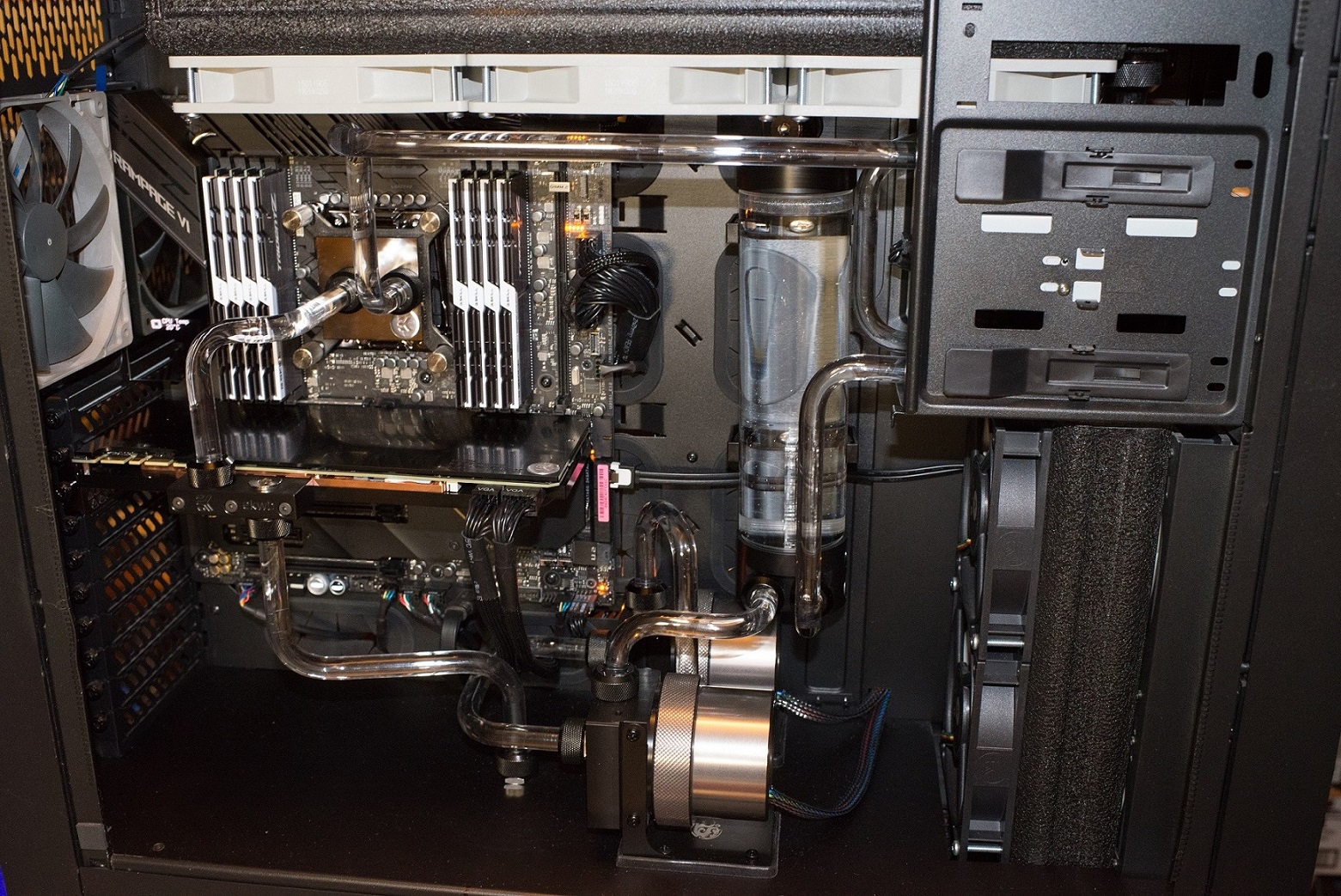

    Looks like one pump leads into the other? Would it not be better to have Pump > Component > Radiator > Pump > Component > Radiator > Res?
    I feel like having Pump > Pump, that the second pump would resist the water flow going into it somewhat, therefore, nullifying the effect you were going for.

    Nope, Martin's Liquid Lab did the tests - the 2nd pump can be turned off and even then it offers very little flow resistance. Pumps can be run at different speeds (even different pumps), all sorts of things and it's nothing but positives.

    I tried running them at different speeds off 2 different fan headers on the mobo, but I never did get them operating just like I wanted - they never tracked with each other very well and the differing speeds were more distracting than just using a Y splitter. If I had a nice controller I still think it'd be a good idea.
