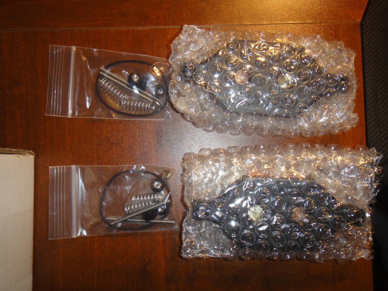

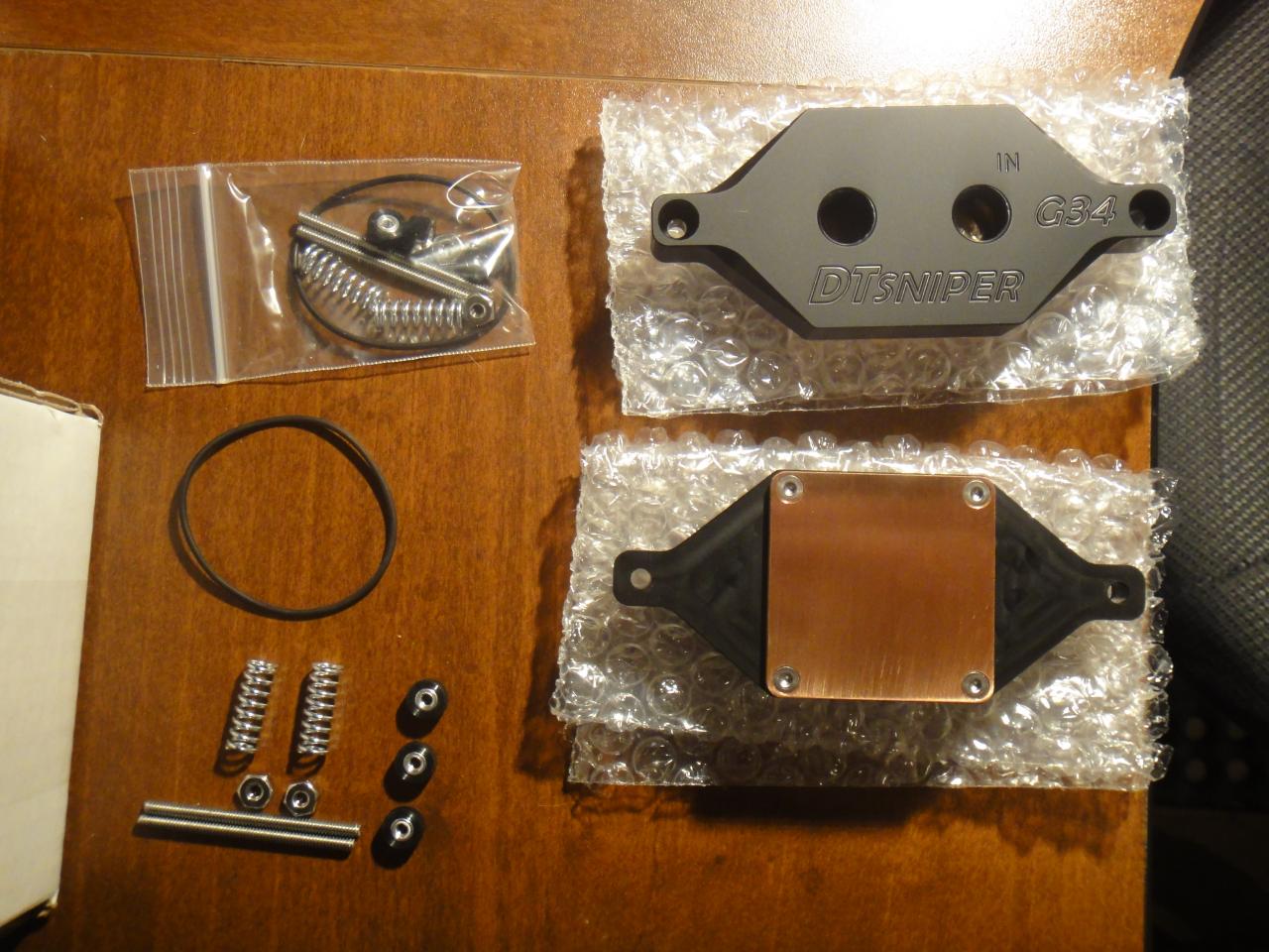

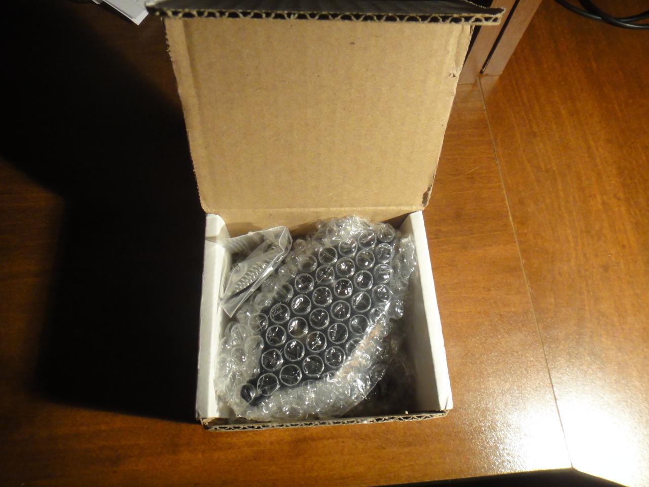

Ordered.

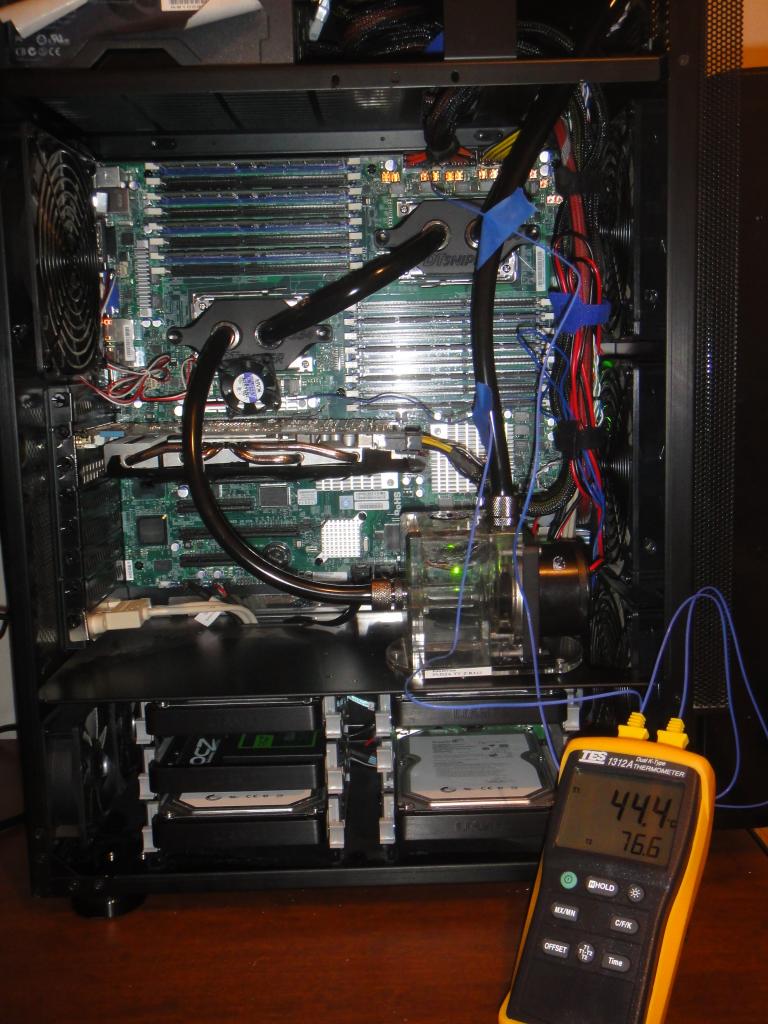

Now let's see how high I can push a 2P with these blocks and a 3x140 Rad :)
Very nice, been looking at blocks for G34 and found the looks of the Snipers the most appealing, plus they have low restriction which is good when you gonna run four in series.
@Brainbug: What size tubing is that? So, are the temps good? Also, the same pump/res I'm getting. :cool:
Tubing is 13/10mm (3/8" inside diameter in imperial)
The pump is set to speed 4
The hotter of the two CPUs is 46C @ 1.3875V @ 4GHz
Please note the VRM cooling, it is really necessary. The thermocouple shows the temp of the two VRMs. Actively cooled is 45C, passively cooled with MOS-C1s is 77C.
