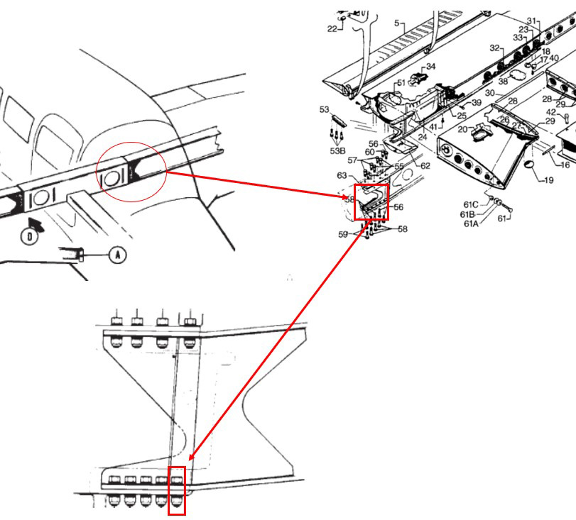

On most planes there are multiple attach points for the spars into the spar box or main fuselage frame. Here is a good image on a Piper Arrow - which DID recently have a wing separation, of how the wings are constructed.
