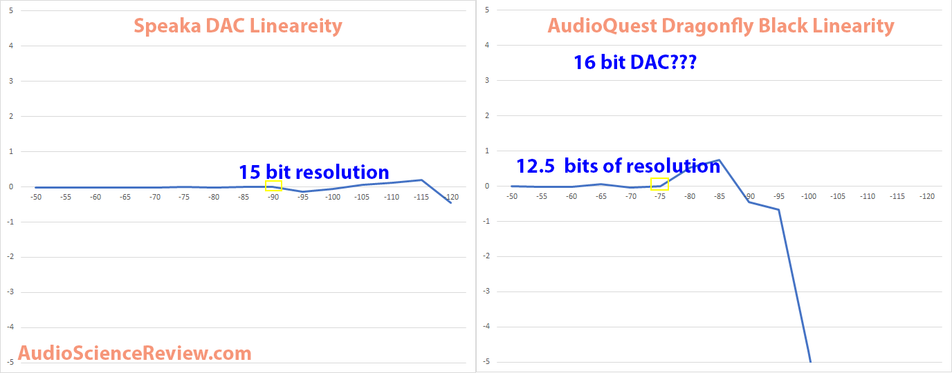

Tested.
https://audiosciencereview.com/foru...-speaka-usb-dac-and-headphone-amplifier.2423/

FWIW, both Black & Red look pretty good in Stereophile's measurements.
I know this and this is why I'm a bit surprised of the measurements in the posted article. Perhaps they had a bad sample. 12,5bit resolution should be clearly audible as noise.
