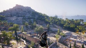

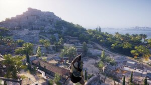

I know in theory what I have read about DLSS, it sounds promising, but from all the screen shots and videos I have seen it lacks detail and the images seem soft in comparison to native resolutions. Has anyone done a comparison how performance and image quality stack up against regular resolution scaling?
For instance in AC:Odyssey on my 4k monitor I did tests at 100%, 80% and 70% scaling. In the same scene average fps was 44, 60 and 67 fps respectively. I took a few screen shots so image detail could be compared. At each step in scaling, detail is certainly gets softer, but I wonder how DLSS would look in comparison along with how performance would compare. Yes I know DLSS is not available with AC, but it is one of the few games I know that have built in resolution scaling for me to quickly test with.
70%:
80%
100%

FYI those images show up as 2000x1152 jpgs for me. I usually save screenshots as PNGs and upload them to a host that doesn't re-compress them (like lensdump) when making image comparisons.
Anyway, here's your 100% screenshot at 720p, zoomed in 2x:
https://lensdump.com/i/W8AJIM
Here's how the graphics driver might scale it to 1440p (Bilinear):
https://lensdump.com/i/W8A6UA
Here's how a good "traditional" GPU upscaling algorithm might scale it, which could be done via an in-game shader or maybe ReShade (Spline36 + Finesharp):
https://lensdump.com/i/W8AQmQ
Here's how a NN algorithm might upscale it. This isn't actually DLSS, but it's something similar (MSRN 2x):
https://lensdump.com/i/W8AVoa
EDIT: Fixed broken images, sorry. Follow the links and click the image for full res.
