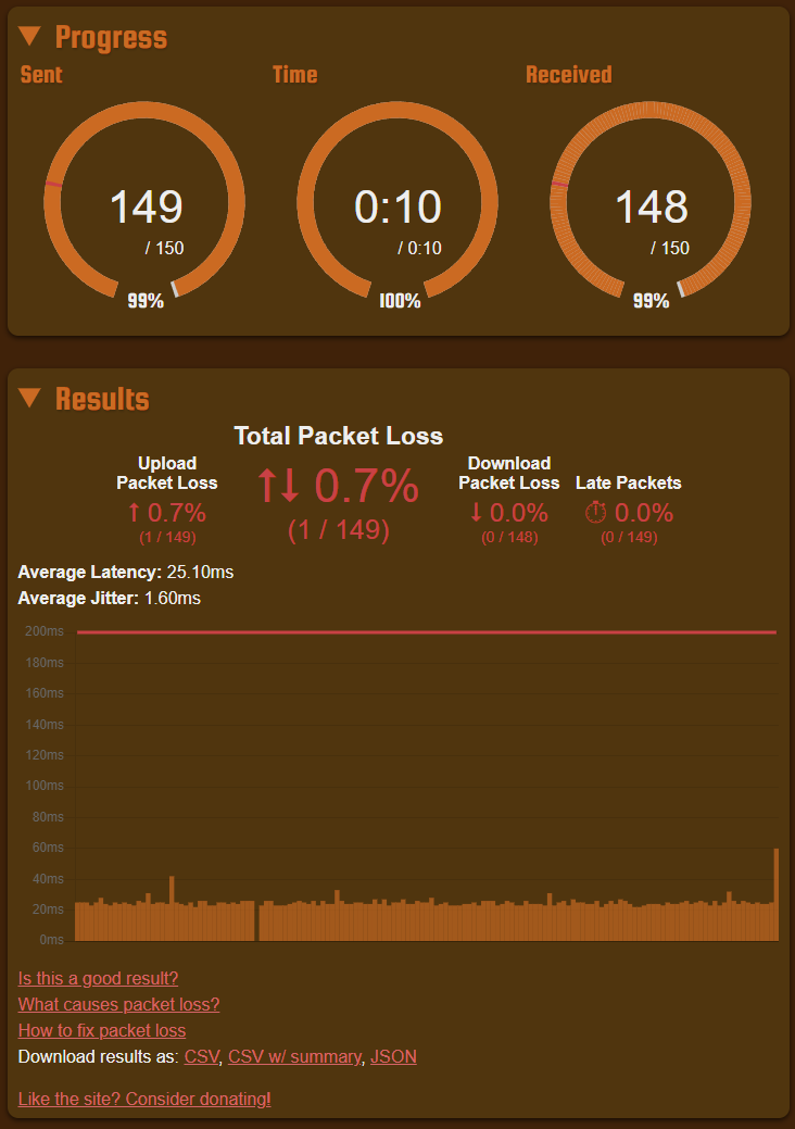

It's not perfect, but have you tried the packetlosstest.com as mentioned? Of course, this could always just be Internet packet loss, so not a definitive test except if that it says zero packet loss, you're in the clear--at least on 1Gb which doesn't seem to have any issues compared to 2.5Gb.
