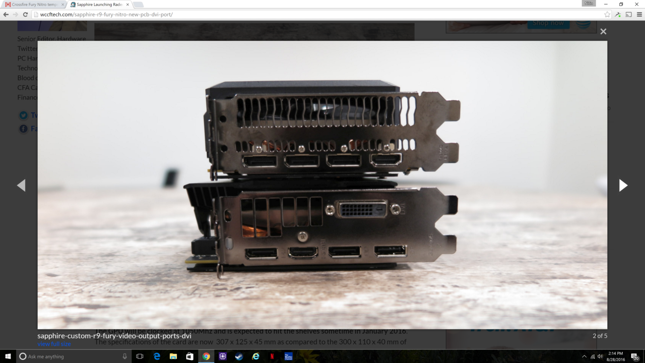

I'm on the waiting for Vega train, but with the possibility that it will be pushed to later into 2017, and with these low cost nitros, I'm considering an upgrade from my 290's to a pair of nitro fury's for better 4k performance.
My concern is the Nitro OC cooler is something like 2.5 slot, and experience has showed me that having cards that close can be bad for temps. But, the cooler on those cards is huge, so I suppose they could pull it off.
So, the question. Anyone running a pair of these in a mb with three slot spacing, and if so, how are your load temps.

oh I don't think nitro oc cooler is 2.5 slot. The cooler is lined pretty well with the outer edge of the slot, its not 2.5 from what I have been seeing in the pics. If the cooler sticks out a quiet bit from the second slot looking at it from the side then it could be considered 2.5 slot. It might be tiny bit bigger, but dont think its that big. I guess I will find out soon lol
I had that problem with my case and msi 390x gaming, it fit in my case but the problem with that was the fans stuck out past the fan shroud and they rubbed against the bottom of the mini itx case. This cooler doesn't seem to have that as fans are inside the shroud.
Its on the bottom. Tiny bit but not a whole lot. My concern is usually fan blades being outside of the shroud like its on msi gaming cards for 390x. Looks like you should be fine. Its not a whole lot. If you are not overclocking shouldnt be too bad. But as always in crossfire you would have higher temps on the main card, its just always the case. 5-10c.
I had my reference 290's in this board, they were hot to start and being that close didn't help. I'm on mobile today, but the pics I saw , plus the one you posted, show it being slightly larger than 2 slot, hence my concern.

I can confirm that the Nitro is larger than 2 slots by enough that you need to have 3 slots between cards. Bottom card hits my revodrive. I had to pull it and get a pcie x4 extension cable to move it to the last slot in the case.
oh dang. Lets hope the fans don't stick out the shroud like the msi r9 390x cuz that card was a pain. The fans rubbed the bottom on my mini itx case. Crossing my fingers.
