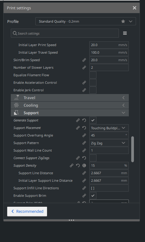

OK, here is my first problem. The creality slicer doesn't seem to work on more complex models with high poly count. It loads the model, but the export button is not active. And nothing seems to be happening.
Tried Ultimaker Cura, but it doesn't have the feature to generate rafts or supports, so it cannot be used for models that needs either.
Also tried Mattercontrol, but it crashes when trying to export gcode. It says it cannot access some file because it is being used by another process. A file clearly generated by mattercontrol itself.
Any ideas?
I am not that in depth on the 3d printing, but is it possibly because of the high poly count, and the nozzle diameter selection that it can't export because the math is not divisible by the nozzle diameter? Is this a small model or just a large complex? I have always used Cura...and have never had an issue honestly.
EDIT: Cura does have rafts/support options. It is under the support tab in the print settings:
Thanks haven't found that menu.
