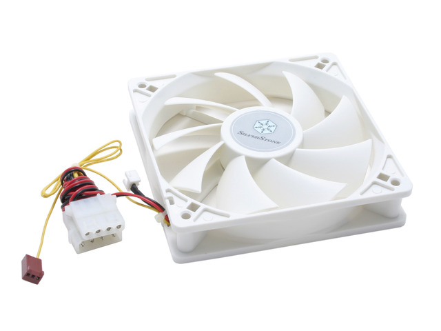

Hi, all. I have a couple questions regarding case fans.
1: When a fan comes with multiple plugs, do you have to plug them all in, or just one? [example]

1. In the picture you linked, you plug in the molex connector and the other plug with the yellow wire is optional. That wire is for monitoring the fan's speed for when it is plugged in.

5. Generally, those slots are used for fans. You can use them to power the fans or if the fan like the one you linked earlier is used, just plug the power into molex and yellow wire into the motherboard to monitor the fan speed. Technically, you could plug in all of your fans into the motherboard but I wouldn't recommend that as it draws current through the board rather straight from the psu itself potentially harming the board. Speaking of which, you also might want to be careful as to what fans you plug into the motherboard as some high output fans draw alot of power and should really be power via the molex connector.
