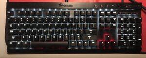

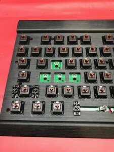

Replaced the WASD keys and convert from red to white LED. Ended up down a rabbit hole troubleshooting the brightness of the LEDs.
Found out the hard way, it's not plug n play with LED colors. The white weren't bright whatsoever.

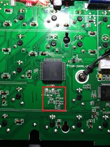

My google-fu failed me in searching to see if anyone else was successful with this mod. Most of them went from blue to different colors. Not red. I managed to locate the resistors controlling the current and swapped them out for 100Ω SMD resistors. Original was 10k.
Success!!!. Keys work and LEDs are bright.
^ I ran out of white LEDs for the arrow keys.
