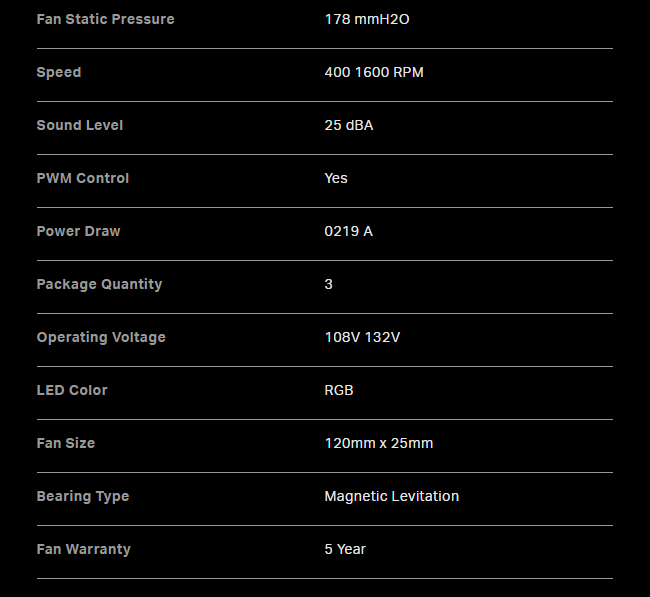

this is the specs for the fans,
The Elite cooler page shows 2400 Rpm for fan speed but I think that is supposed to be the speed of the pump.
Also note that the voltage specs are wrong on the fan specs, lol.

and they are always +/- 10%, which would be 1440(-10%). so it he's nudging 1500 they are running within spec.
oh and i think youre right about the pump speed thing, thats about what all mine did.

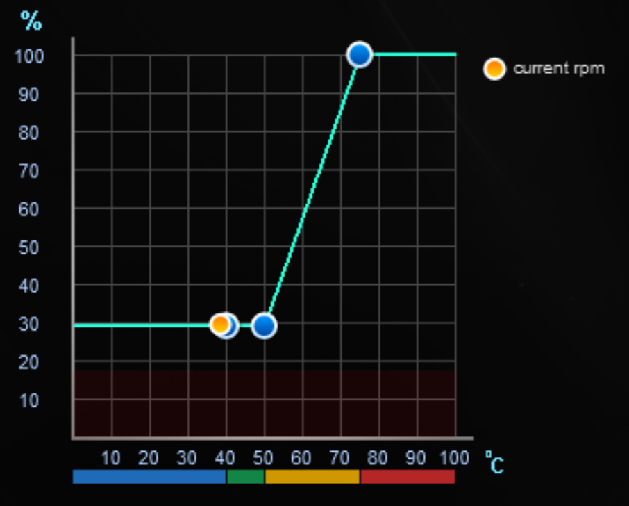

and if you havent played with your curve yet, i recommend a flat 25-30% until 50/55ish and then straight to 100% at 75.
like:
