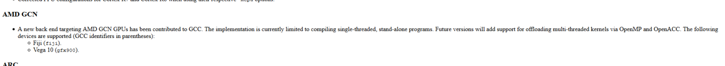

openmp it seems that now only can do single threaded applications (GCC 9)
and computecpp is an implementation of sycl for Windows and seems to use OpenCL1.2 for Sycl https://www.khronos.org/assets/uplo...computing/SYCL-Compute-Cpp-Overview_Nov17.pdf also uses C++ for the source instead plain c like OpenCL
