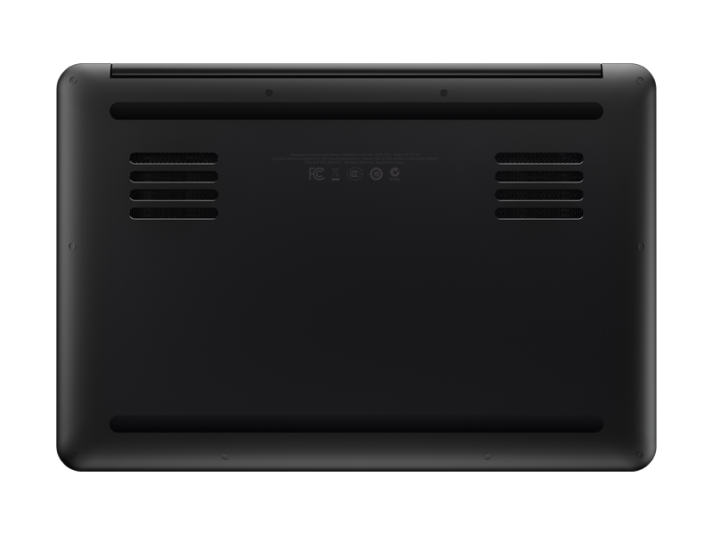

Here is the bottom of the laptop.
If I find the CFM rating of those fans and match or exceed that rating by the smallest amount using cooled air, what do you think? Maybe even divert a little extra against the bare chassis as well.

Here we are tracking, but it's still going to be touch and go because the bottom shell of the case isn't really in touch with much so yes, we can cool the bottom, but to what effect that has on the rest of the system, I have my reservations.
Question: does the area around your vents that gets really hot include the bottom of the chassis, and is that part metal? If yes, I would predict that even just cooling that area (rather than the whole bottom) would actually have bigger results than you might think. I guarantee that Razer is using a heatpipe setup, with the actual heat dissipation fins right by that outlet. If that is where the majority of the heat-dump is coming from, that is where you should put the majority of your heat absorption capability. If the chassis at that point is metal, I can envision that transferring heat from that point to another cooling apparatus would be reasonably straightforward.

The wireless card is mounted directly below the right fan in the picture you provided. I highly doubt it's having thermal issues there.
The smooth alu base of the unit doesn't actually touch anything heat producing, so actively cooling the bottom lid is almost entirely pointless.
Some cooling pads will actually reduce the effectiveness of the stock cooling fans.
In thour situation, I'd simply try to prop the rear up about 1/2-1 inch. Give those fans a large space to draw from so they don't get starved, and keep the vents pointed in an upward direction to help keep it from recirculating hot air.

Jorona, that does look like a wireless card on the right near that fan. But the fan is part of an enclosed ducted system that cooles the CPU and GPU, perhaps GPU Ram as well, and vents it out at the top near the display hinge. It seems that the rest of the laptop could suffer from poor ventilation as if the designers were so busy solving the CPU/GPU cooling that they forgot about the rest of the system and that heat could build up over time in long sessions.
