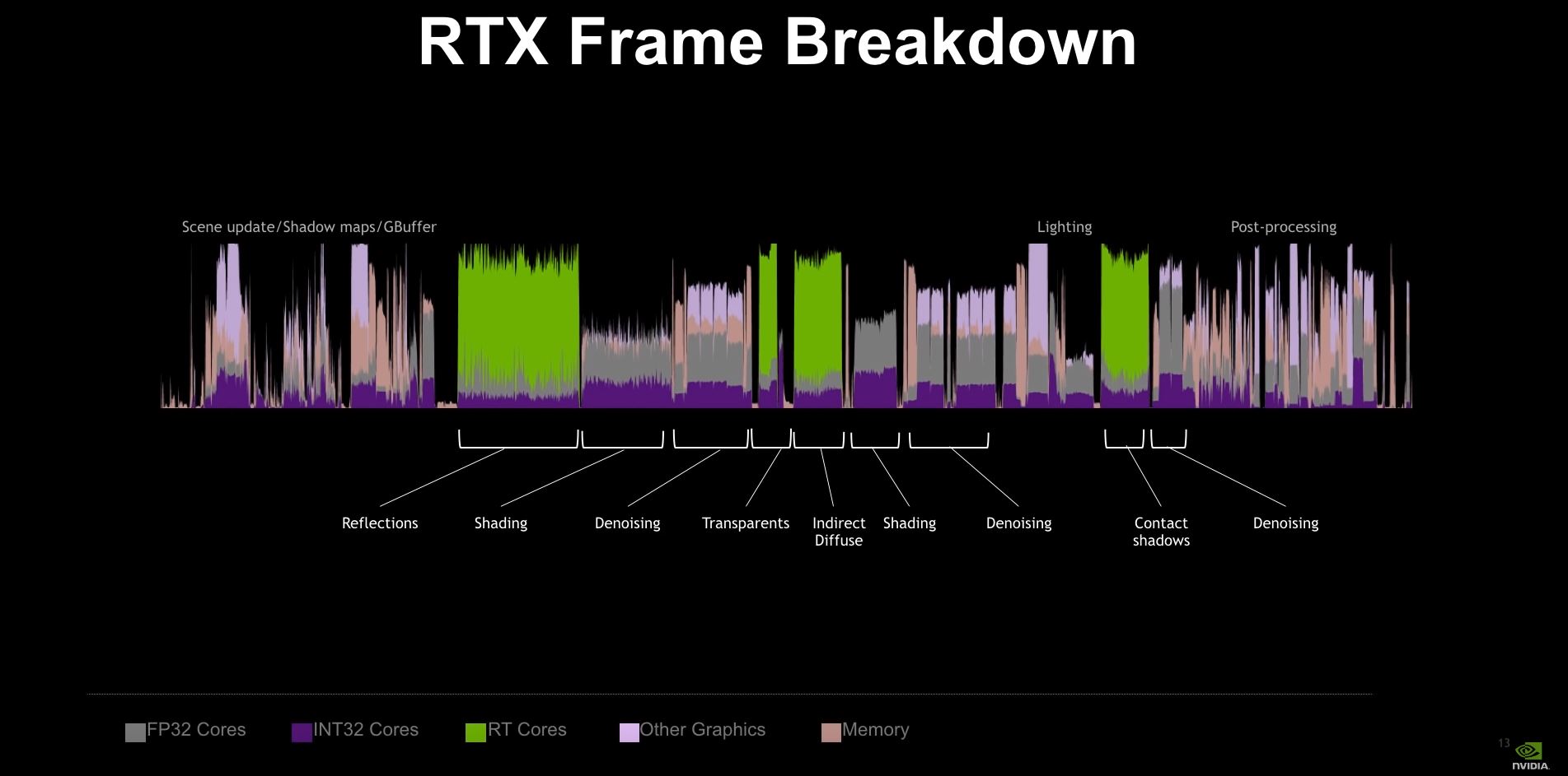

I like these frame breakdowns (4:12), so you can see where the RT cores get a workout. There was one of these for Metro Exodus, but there was only one section for RT cores, here there are multiple sections of RT cores, followed by shader, and then a denoising pass. Three of each this time.
Yeah the breakdowns are really interesting. Goes to show that there’s a lot happening each frame and performance is bound by different things depending on what type of work is being done.
I don’t know how accurate that visualization is but I was surprised to see such low memory bandwidth usage during the RT steps. Maybe the entire BVH structure fits in L2.
It’s probably just how the graph was drawn and the green RT section is blocking the memory graph.
I wouldn't expect the memory to be utilized much when the GPU is just crunching numbers. You can see when the framebuffer updates and postprocessing happens that the memory gets hit really hard, which is where I would expect it to. I didn't do a lot of shader work, and it was with SM 2.0, but I remember needing to try and simplify color calculations as much as possible to keep the memory from becoming more of a bottleneck than it already is. Bandwidth is around 20x wider than it was back then, but we have added a hell of a lot more to the postprocessing part of the pipeline since then, too.

You need a Beast of a GPU for this, not just for the RT cores to do the intersection testing, but shader cores for shading, and then the denoising component. Nearly every effect needs those three steps, and here repeating those steps multiple times over in a single frame.
Shading + Denoising each RT effect is often taking more frame time than Intersection RT core work!
Look at the frame breakdown. Reflections - Bunch of Green on graph for RT cores testing the rays. But then there you have to shade those Rays of the Reflection on the surface, then finally you need to denoise.
There isn't going to be a big jump in RT HW soon because you need more of everything. More RT Ray testing, more Shading performance, and more Denoise performance.
