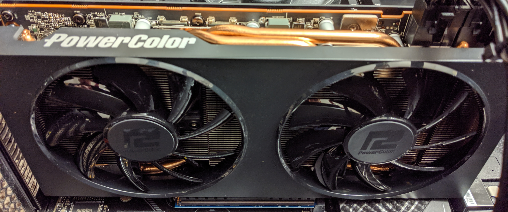

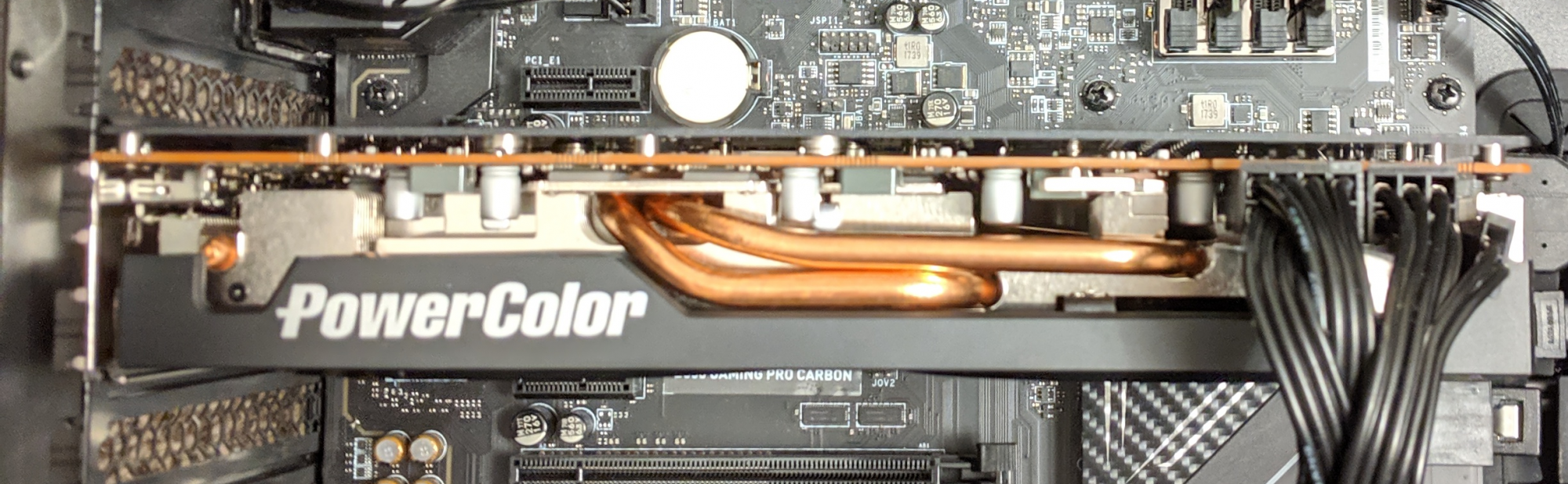

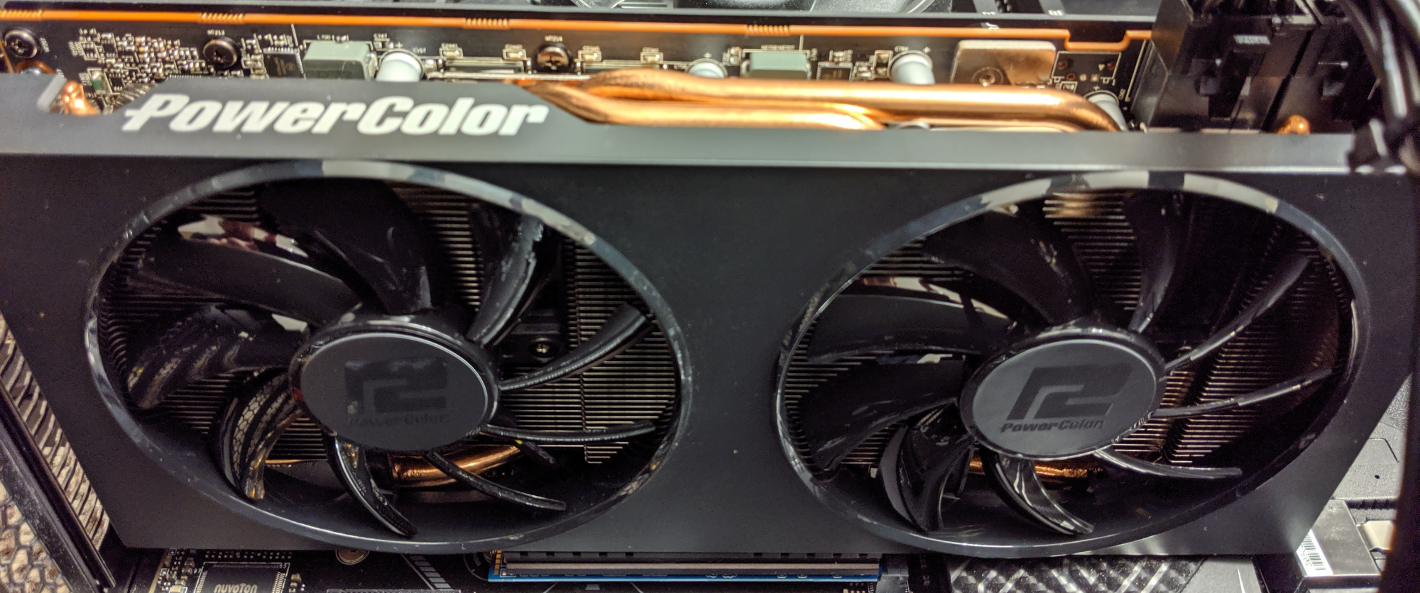

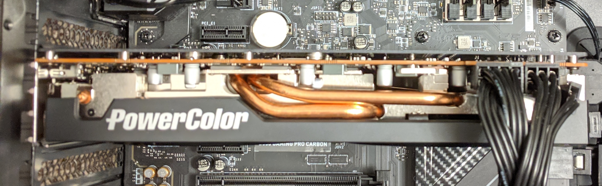

Since there seems to people here clued up on the 90° rotation + heat pipes issue...
How do you think my PowerColor Rx5700 XT Dual Fan (Not Red Dragon) would fare?
It has three heat pipes - two under the source of heat and one above.
But it has the advantage of horizontal (or I guess vertical when rotated) grills which mean it should benefit from the rotation and the possibility of mounting a fan above it to suck out it's exhaust.
How badly do you think it would be affected by being rotated?

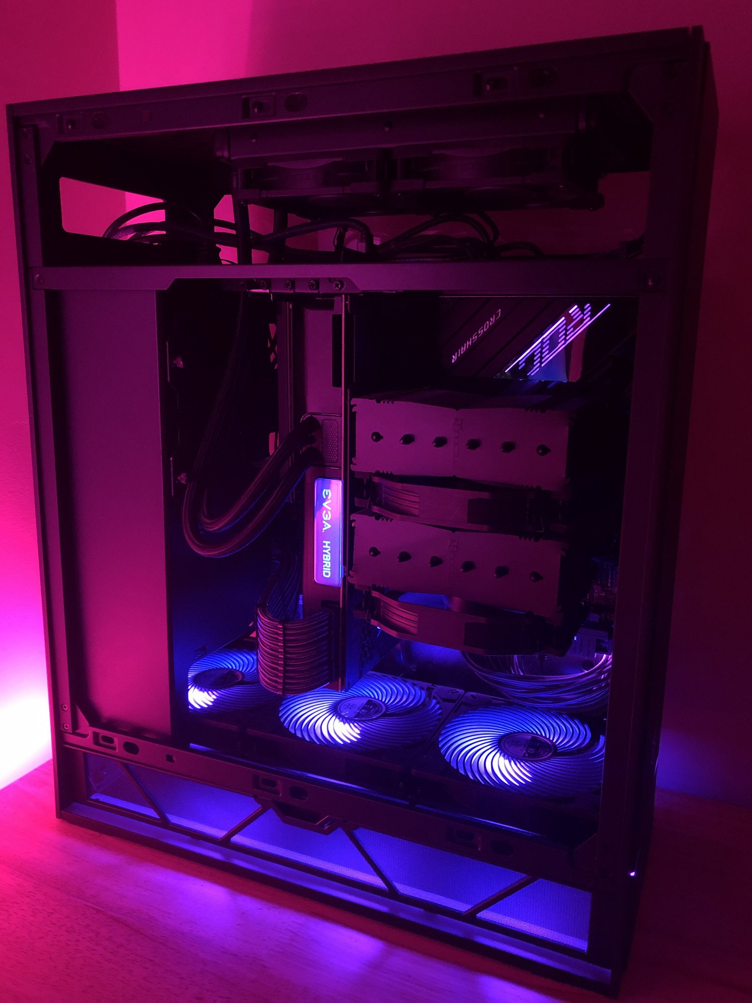

Folks, it happened. I did it again, swapped GPU for RTX 3080 TUF, bought Alta F1 and guess what.....
GPU on silent BIOS - max 71 degree, CPU - 75 degree.I can officially state, that this specific GPU is working fine in this layout.

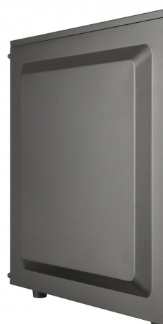

BTW - are there plans to sell solid metal panels separatly? I didnt writed any review yet about the case, but its really small space for cable managment. My 24pin cable for motherboard is pushing glass panel out (its braided, but rounded, not flat), every opening/closing side panel is pretty hard. Same for fans cables - there is only one way to route them - through holes on top "service" panel. I had short cables for fans and needed to use extensions to reach fan ports on motherboard beacuse there is not much holes. Metal side panel COULD have more spacing, just like this:
Also You guys made good decission of side panel mounting mechanism, but bottom rail on side panel itself is little bit too short - user need to hold panel almost vertically to fit rail in case frame. Solution seen in Cooler Master Maserbox 5 would be much better (panel bottom rail was much bigger, that let the panel angle while opening much more, hence make it easier to handle/mount).
Anyway, i'm very happy to look at my PC now, its cleanest looking case i ever had, even without rubber gromets - those also would be nice addon for case in future (revision 2?)

About solid steel panels....
I just need to ask again - when ? ;)
This is just a sticky foil, as you can see it doesnt match color at all, but still looks better than visible cable mess.
I'm not that happy with resoult, as i got lot of scratches (it was meant to be scratch resistant, as its for cars tuning - they stick it over whole car body) and got 2 little folds that are visible, but still no cables visible.
So got my case today and prepping to build. Lovely looking case to be honest and will be a worthy upgrade to the FT05 I think.
I will say though the case needs a few tweaks. Namely, the top fan/radiator mount needs to be toolless removeable with a fan & rgb 'extension' header on the top (if I missed this, my apologies) . As is, if I need to plug something in I think I'm going to have to remove the side panel if I have a rad or fans up there?!?. With a fan extension header there, and with many fans now being daisy chainable, that'd provide a quick way to do work in the top of the case. And some sort of mesh grill to 'delete' the above motherboard header fan spot to clean up the case as well.
I do think if I wasn't such a Silverstone diehard {(I'm currently cramming a 5800X+3090 into a Sugo 15, lol) (and maybe if there were reviews available)} I might have skipped this though and either kept my FT05, or looked into the CoolerMaster Cosmos
